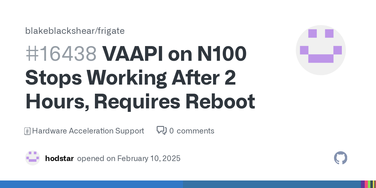

i also open this issue at Github, hope this will bring to end this issue.
