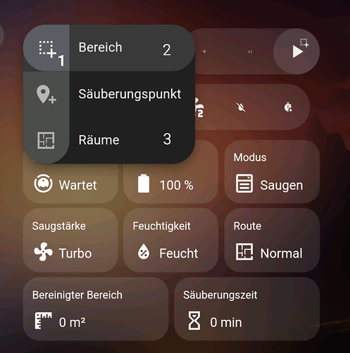

Do you mean the âSelectionâ option in the editor?
I mean this: I change the platform to Setup Integer, I make a zone selection somewhere on the map, I click the âstartâ button and then the âSelectionâ remains empty ([ ]). I also then receive the error that can be shown on the screenshot below alongside the steps I do to get there
Selection should be updated the moment you create it on the map. You donât have to click âplayâ button. Can you open the card editor, hoover the mouse over any of 3 icons in the center (play/pin/fan) and check what text is shown in the tooltip?
Iâm sorry, Iâm not sure if this is what you mean:
(I had my cursor hovering over the pin icon while taking the screenshot)
Yes, this is exactly what I meant. Was this screenshot taken in the card editor?
Yes, if I understand correctly by what are you referring to as âcard editorâ, opening my dashboard that contains the vacuum map card, going into edit mode of the dashboard, then opening the map. If this, then, yes this is how I made this screenshot.
