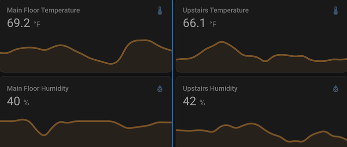

Ideally, I’d like to have the ability to do something like my thermostats.
