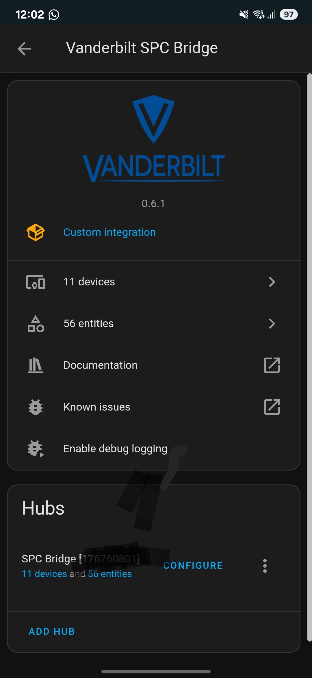

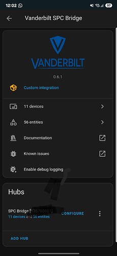

The new SPC Bridge Lite from Lundix works perfectly with an SPC alarm and gives full HA integration. It also supports encryption and so you don’t have to disable encryption.

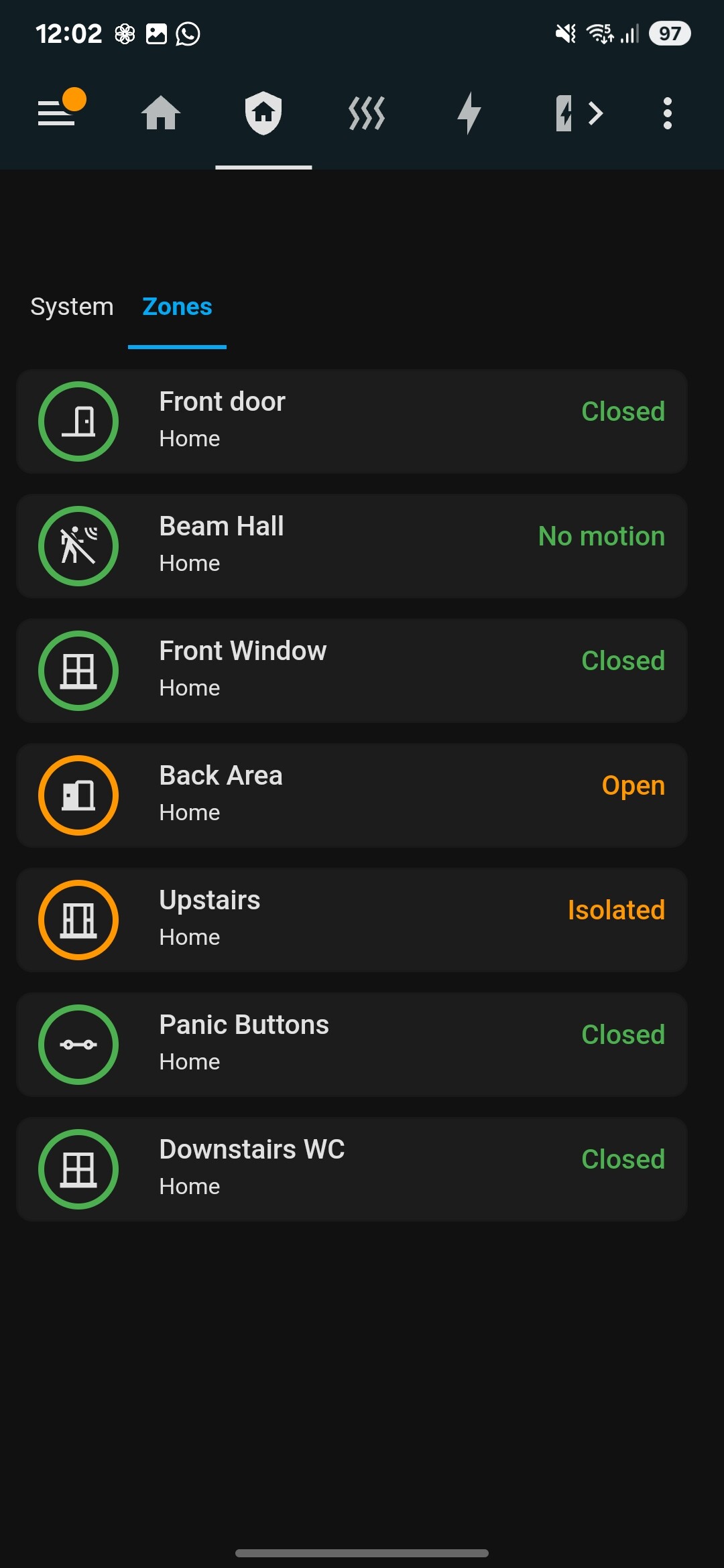

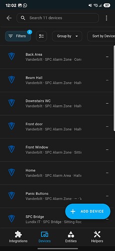

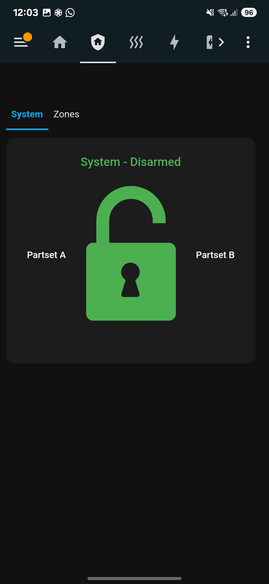

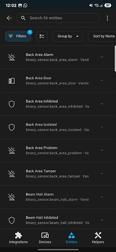

Everything from the alarm is exposed. I see 11 devices and 56 entities. When I set a part or full alarm, it turns off the lights and TV and AV kit. I also have a check that if I set the alarm at night, it checks that the car is locked. There’s pretty much everything available.
