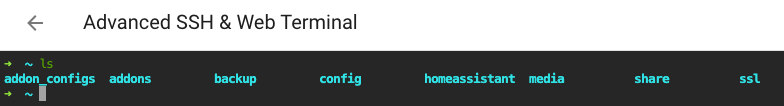

This thread is almost a year old but the ssl folder is in the root of the Home Assistant directory.
