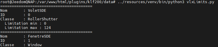

Is there any progress in this PR (https://github.com/home-assistant/core/pull/64628)?
The Python library used by this integration is offering this value for a long time.
This value (minimum limitation) is important because it indirect indicates rain status and blocking the window for opening and would be a major value in Velux window.automation.
So, is there a plan to integrate this value/attribute to Velux integration?

As I said: The used Python library for this integration is offering the value. The value is important for automation.
So, it’s just that PR-acceptance.
The Velux-API is known for that (indirect rain sensor) value since 2018. In 2023 it could be the time to integrate this value to Home Assistant official Velux integration.
Edit: And I personally don’t care if this is done via the marked PR or any other PR. At the end of the day the goal is just to integrate the min. 5 year old available value of “limitation minimum”.

Yes, I replaced the HA Velux integration with the code in the PR. It works perfectly.
It’s really a pitty, that such PRs don’t get it into the official repo just because of being ignored for too long time.
In the directory /config/custom_components/velux add these files, which will replace the core integration:

Hi, I can’t figure out my issue. I have the latest version of HA with Velux Integration. My window sensor is not reporting rain even though velux API does. I have not been able to trigger debug logs from Velux integration instead I have executed this script – sorry in french –
which reports this
Nom : VeluxCuisine
Classe : Window
Limitation min : 89
Limitation max : 124
While when there is no rain it reports
Nom : VeluxCuisine
Classe : Window
Limitation min : 0
So it seems that limitation.min_value changes between 0 and 89 for my hardware.
I can’t correlate 89 with 13% or 7% I read in this chat so does it mean I have a unsupported hardware that need to be included ?
– note: exposing value_min and value_max directly as attributes as proposed here Velux Rain Sensor - #5 by MaasOne by would allow me to create my own template I wish this would be implemented.
Can you create an issue for the Velux integration in the HA core github repo and attach debug logs for both a situation with and without rain detected (if you can reach your rain sensor you can easily trigger this by using a wet cloth touching the sensor)? I’ll have a look at it then and possibly create a PR with a fix.
If debug logging for some reason does not work, you can also run your script with debug logging enabled and attach those logs, that should do it as well. Although if debug logging does not work then that is probably worth another issue :smiley:
On the wish to have the limitation as an attribute: I can see that, but the core developers of HA want to move away from attributes and would rather represent things in separate entities, so a PR to simply expose the limitation as an attribute will most likely not be accepted.
