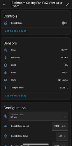

This repo worked like charm for me… GitHub - eriknn/ha-pax_ble: Home Assistant component for Pax Calima bluetooth-enabled fans.
You can add it via HACS. Just add it as a custom repository integration and install it normally.
From there PAX integration becomes available in your devices where you can add the device.
You’ll have to get the MAC address and PIN code from the device. Just pull the fan out of the device (make sure you turn the power off just in case) and you’ll find them on the right connector leg.
I have 26 entities available along with the humidity, lux, rpm, boost mode and a lot of configuration options. It might even be more useful than the app on your phone.
