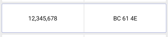

To get the value for a Svara, enter the PIN from the sticker in a Decimal to Hex converter. It will convert the 8 digit number into 3 hex pairs:
Reverse the pairs and add 01 as the last pair.
For example, BC 61 4E would become 4E 61 BC 01.
