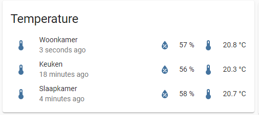

I did not try to include the icons, but this worked for me:
type: entities
title: Temperature
  - entity: sensor.mijia_ble_3_temperature
    type: 'custom:multiple-entity-row'
    secondary_info: last-changed
      - entity: sensor.mijia_ble_3_humidity
  - entity: sensor.mijia_ble_1_temperature
      - entity: sensor.mijia_ble_1_humidity
  - entity: sensor.mijia_ble_2_temperature
      - entity: sensor.mijia_ble_2_humidity

With icon here too:
type: entities
title: Temperature
        icon: true
        icon: true
        icon: true
        icon: true
        icon: true
        icon: true

Thanks. I’m embarrassed to ask, but how would I swap the humidity & temperature on the right? No matter what I do, I can’t get it to work. I still want the thermostat icon on the left.
Doesnt work it by sorting the entities in your code?
The rightmost data element is defined by the main entity in the list, so in all my previous examples mijia_ble_3_temperature. In the example below I changed it to mijia_ble_3_humidity. This creates the following:
To let the icon on the left still be the thermostat, you have to change the icon of the main entity (sensor.mijia_ble_3_humidity) to a thermostat. However, this will also make the rightmost icon a thermostat of course. To negate that you have three options: 1. add the icon option (example given below), 2. could use another sensor (sensor.mijia_ble_*4*_humidity maybe) to create the rightmost icon, 3. just remove the right icons altogether.
type: entities
title: Temperature
  - entity: sensor.mijia_ble_3_humidity  # this is the main entity. The data of this entity will be shown rightmost
    icon: mdi:speaker  # to force different icon
        icon: true  # if true, this element will only create an icon
        name: false  # if false, element data is shown
