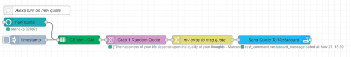

Now, asking my Alexa to “turn on new quote” will fire the flow, grab the entire column of quotes from google sheets, pick a random one and send to my Vestaboard:
Here’s my node-RED flow:
I’m using the GSheet node for this.
PLEASE take note that my columns and configs use the C column (I was doing some concat in the sheet and ended up in column C)
Here’s a look at the google sheet:
This has been working flawlessly for some time. Drop me a line, if you have any questions.
