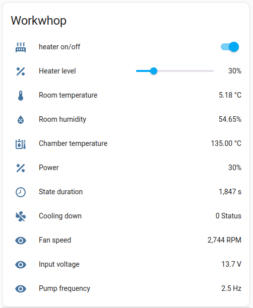

Vevor diesel heater control - development in progress
Hey. I bought Diesel heater from Vevor brand and with disappointment realized the protocol used differs from common protocol used in Chinese heaters.
Because no solution was that time available, I started investigating and created my project.
Right now, with great certainty I can read Chamber temperature, Input voltage, input current, state and fan speed. There are many other things related with glow plug, but right now I cant assign them to proper values (and actually I dont really care).
Once there will need to run the heater on and off remotely, I will finish this part of state machine and then it could be used as complex working component.
Feel free to join me on this journey.
https://github.com/zatakon/vevor_heater_control
Edit 16.2.: full control of Vevor diesel heater is now possible from Home Assistant

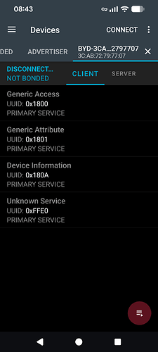

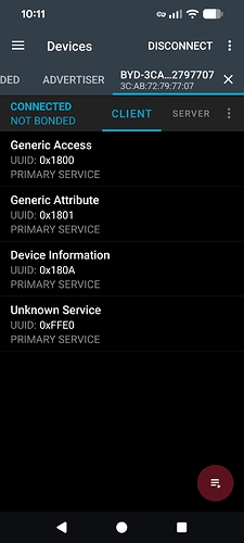

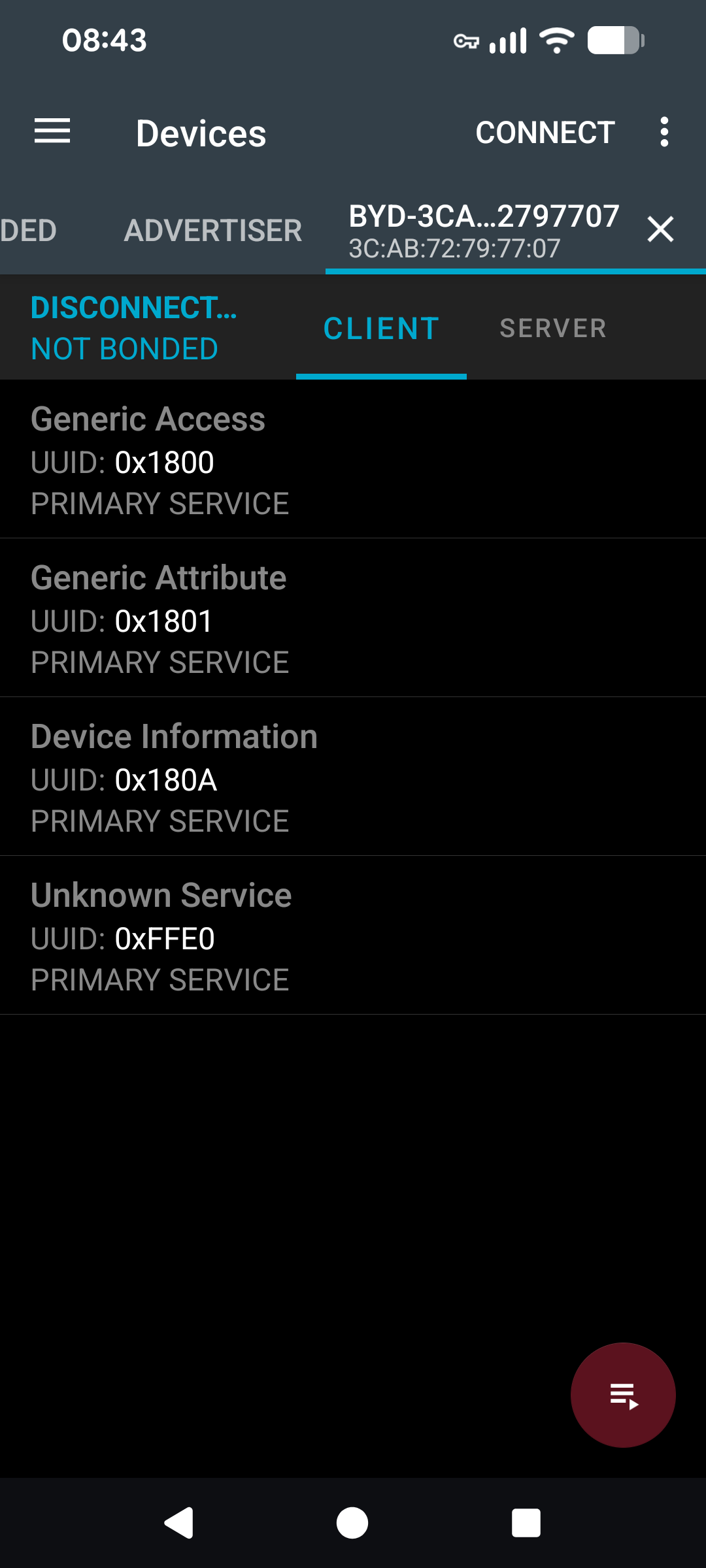

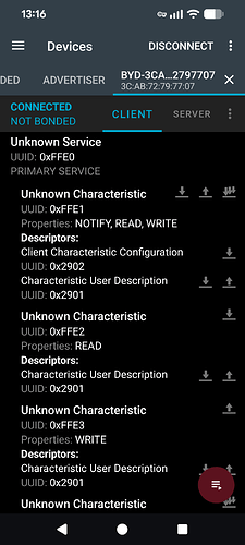

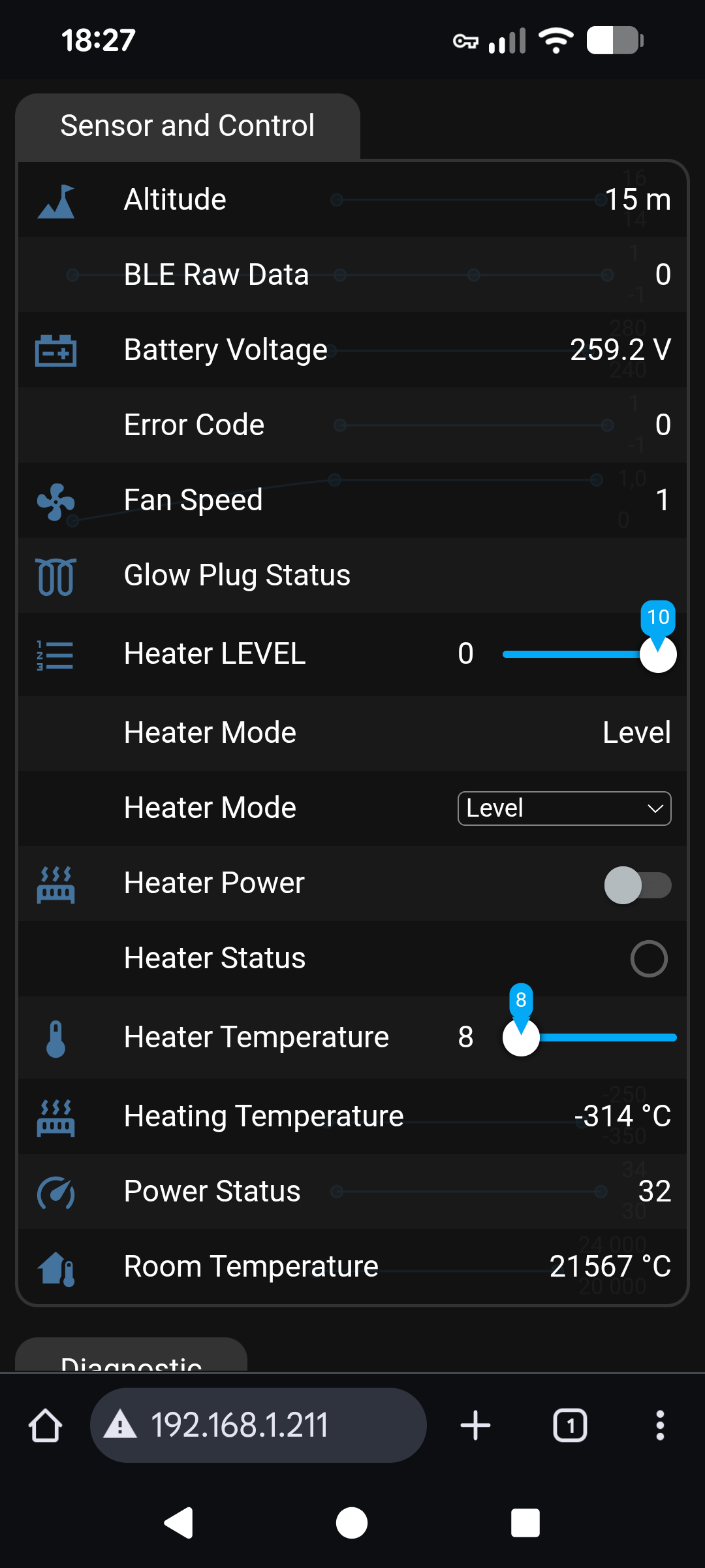

I need help with my Vevor Heater.
I currently have the yaml uploaded from GitHub:
This is actually the only partially working example:
  • I can turn the heater on, but not off.
  • I can change between Level and Automatic.
  • I can set the heater level.
  • I can set the heater temperature.
    And that’s it. The other parameters don’t match at all. It shows complete nonsense, as you can see in the screenshot.

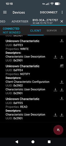

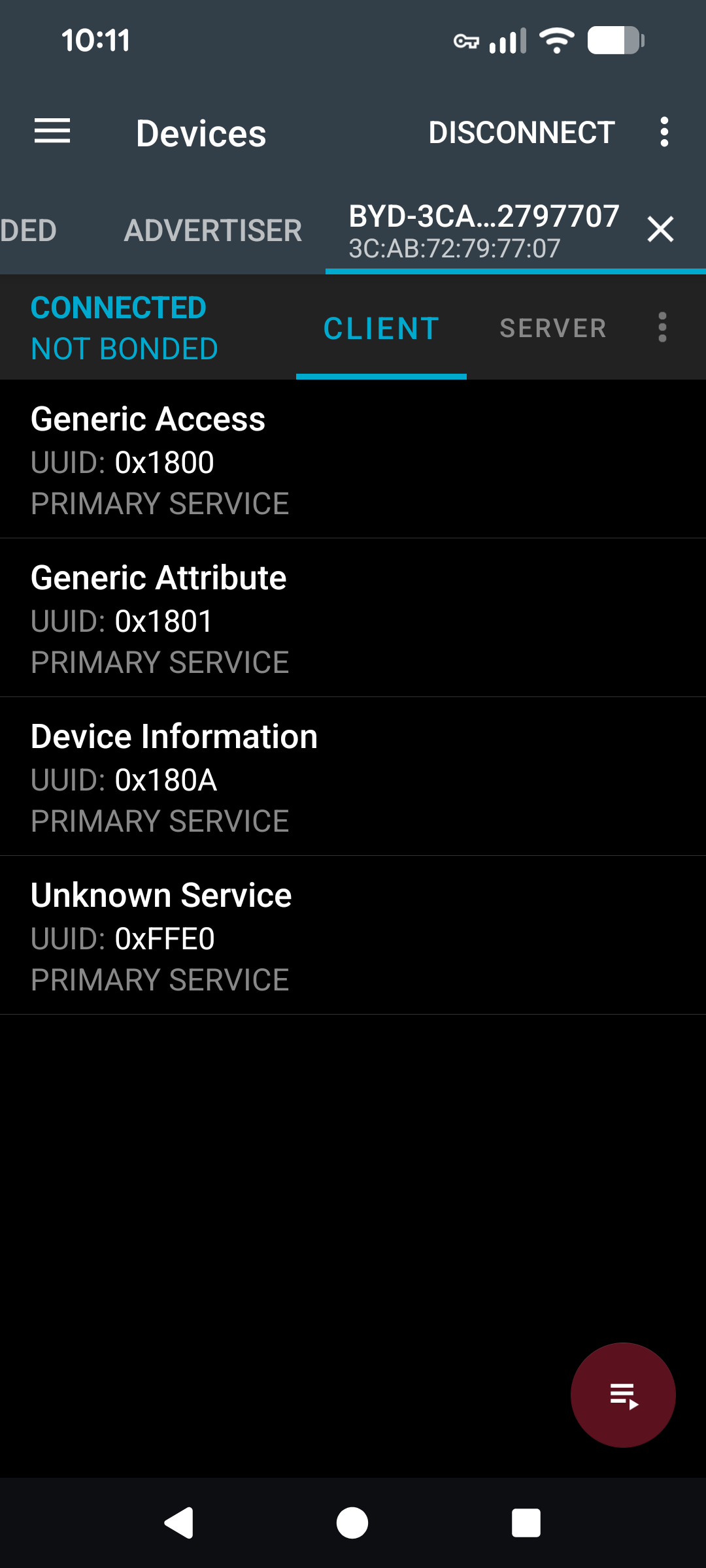

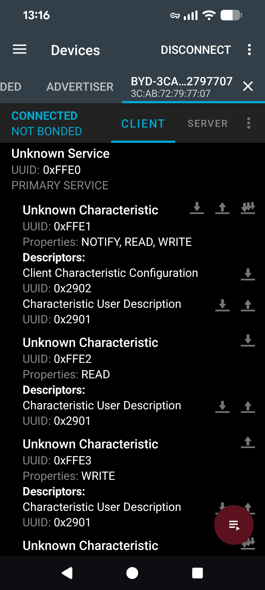

    I’m also attaching a few screenshots I took with the nrfConnect app.
    How do I find and match the correct data to my Vevor?
    I’d appreciate your help again.
    Best regards.
That seems to be the same controller as mine.
I’m sorry to say, but I can’t help you fixing this issue.
I just shared the yaml working for me.
Although I tried many scripts and versions that didn’t work.
Beim mir ist das gleiche Programm einschalten geht der rest falsche werte gibt es eine lösung

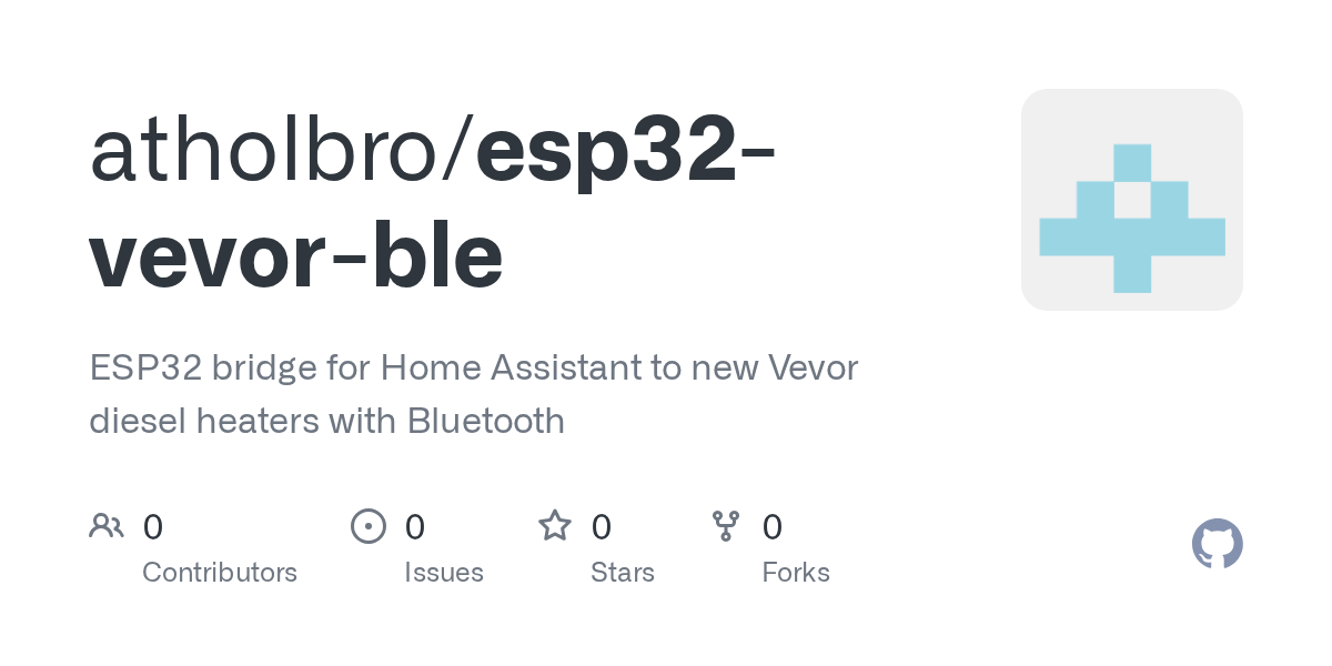

I had the same issue where the currently available scripts could control the heater but the telemetry values were way off. It seems there’s a new firmware version / controller which encrypts the bluetooth packets.
I was able to figure out the new packet, here’s an updated version that works with my heater:
I moved most of the configuration into secrets.yaml so you’ll need to add your heaters mac address in there.

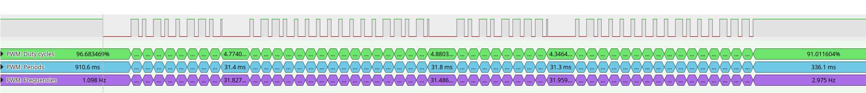

I have developed a esphome library for Vevor PWM protocol based heaters using esphome’s RMT peripheral. The protocol is very simple and the heater can be fully operated (both transmit and receive). The same hardware (transistor circuit) can be used as with these UART based heaters @zatakon has made support for. This due to the fact, that data bus is still 5v and tx/rx also needs to be inverted.
PWM data bit in these heaters is 12ms long which means 83bytes/sec possible data rate, although it sends just 8 bits and retrieves 16. I suggest first connecting a data analyzer to determine the signal type. You wont get much data as UART based heaters, but the most important as battery voltage, fan status, power level and heater status/errors is in there. There may be some data still to decode, but it’s no big deal.

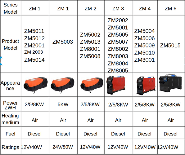

Supported heaters: Vevor ZM8001 and more unknown, it looks just like ZM-3/ZM-4.
Check this table:
Waveform:
PM me if someone is interested, I can publish my project open to everyone. Just need a bit of free time to tidy up and do some writeup. :smiley:
