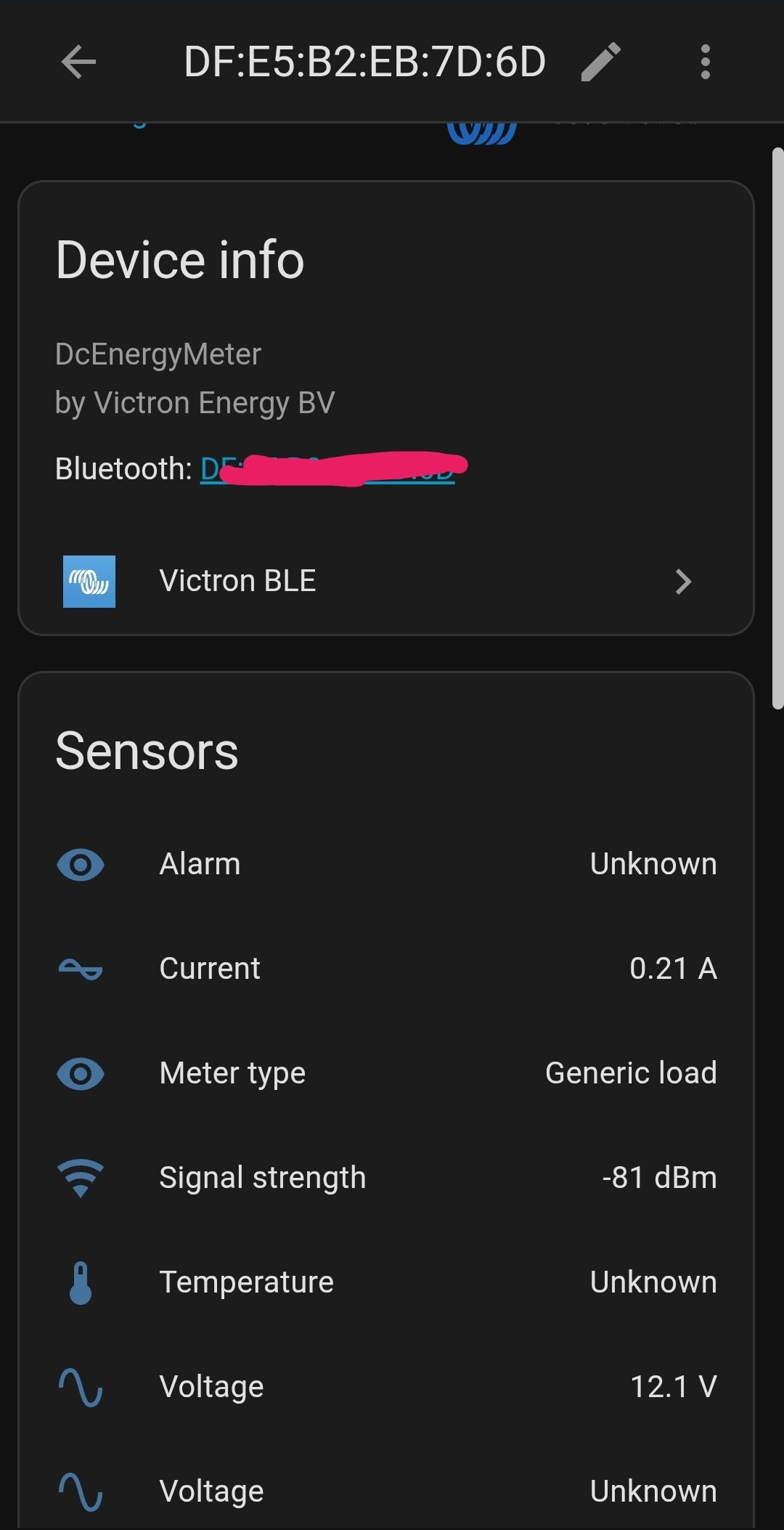

Thanks Anto, Would you be willing to post a piccy of the entities etc please?
Sure, im using the device as a meter (mode) so some entities are unknown
