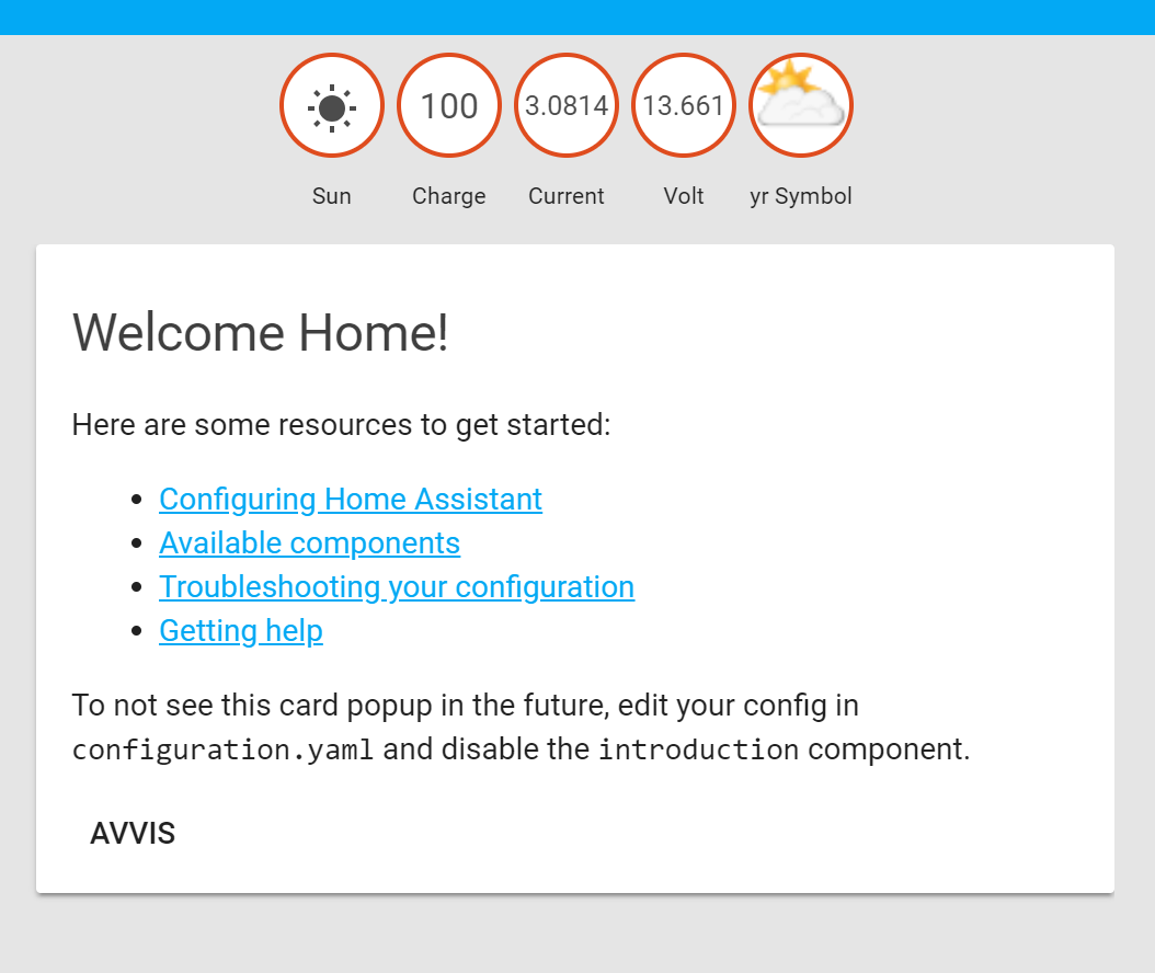

I have now done a script to dump the data from USB to a text file that I have imported as sensors into Home Assistant. At least now I have Charge %, Current draw/input and voltage on the battery. I think the USB is the way to go to make this easier.

Not sure if 5 and 6 could be combined with a more clever script in HA that could pull directly from the serial interface, that is probably possible. I am working on getting the file output in 5. to become JSON. Today is is CSV or one value per file (this is the screenshotted one). Once I have finished I will upload all my configs for sharing and improvement.
