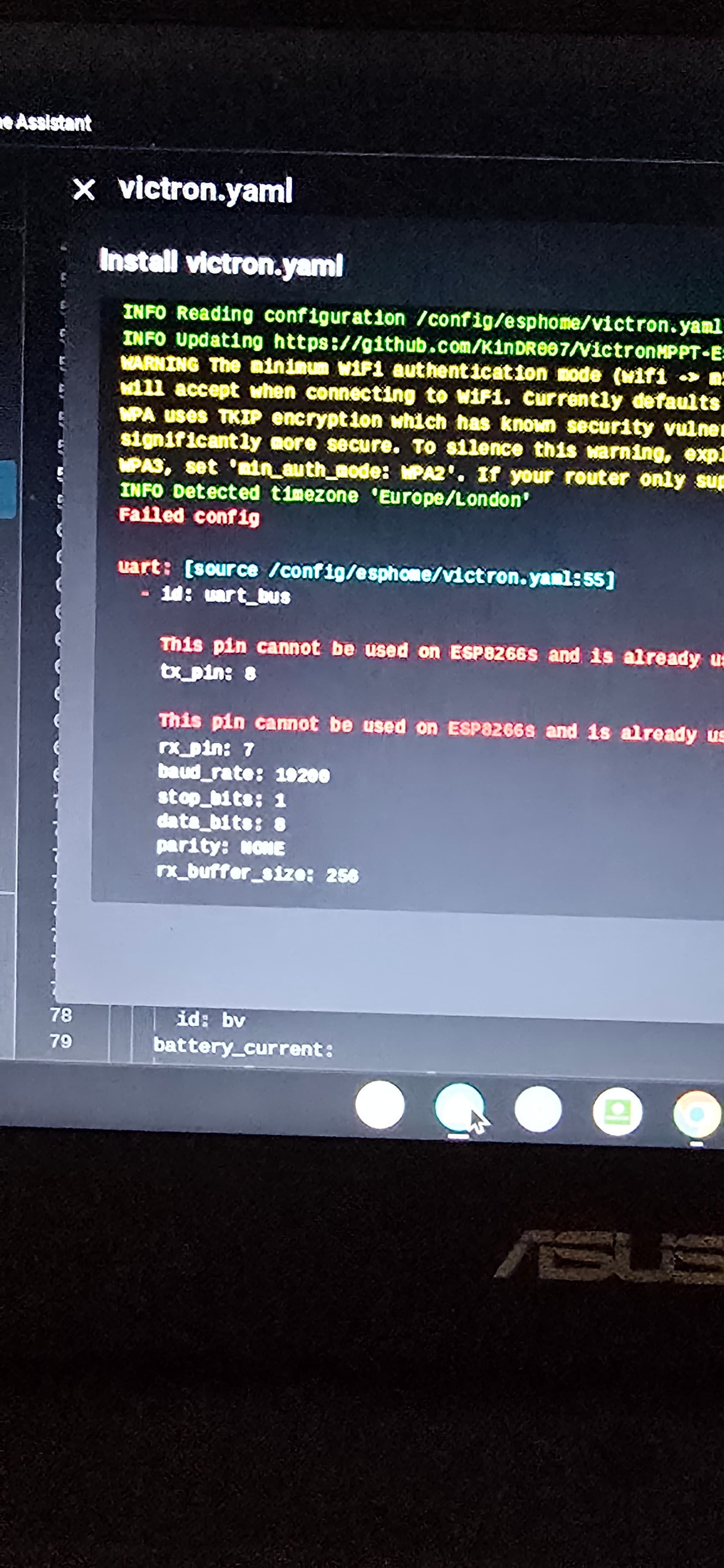

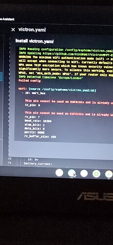

After seeing this I got an ESP8266 connected to my charge controller and reporting to HA.
I’ve now ordered a Victron Shunt.
My question is - can I add the Shunt VE.bus to a different GPIO pin on that same ESP8266, or do I need to use a second ESP8266?
I’m planning on the same thing for a Victron Blue Smart Charger and a SmartShunt. The below config seems to be valid. You need two UARTs, two Victrons and then you can compile the sensor list accordingly.

Yes, that’s what I’ve done following some Googling. Thanks.
When I’ve tidied up the code I’ll post it. I need to sort out which entities are available from the charger and the shunt and decide which ones I actually want. I’m also using it (ESPHome/ESP32 S3) to turn on a relay to go to mains charging for those dark days in winter.
Additionally, the ESP32 has an RGB LED which I thought I would get flashing different colours to indicate different states.
Hi do i configure different pins?
