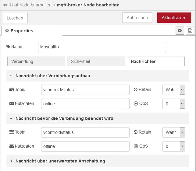

And the MQTT sensors :slight_smile:
- platform: mqtt
  state_topic: "vcontrold/aussentemp"
  availability_topic: "vcontrold/status"
