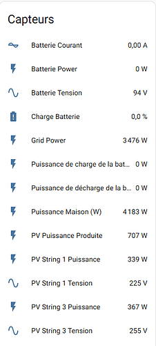

I’m in the same situation as you, Vitocal and Vitocharge VX3 with 6kWh solar panels and 5kWh batteries. I can’t see the information from the Vitocharge.

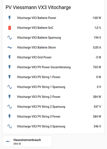

I had the same problem for a long time. The Viessmann API is not working with solar system and battery. But I found a solution that worked like a charme. It`s in German as I am too, but language can be changed in the important parts. Only thing I needed to change here in the explanation was that there are four commands to start up open3e services in one box, I needed to start the commands one after the other instead of all 4 at the same time:
After that all my entities of the Vitocharge VX3 were shown and can be used for free.

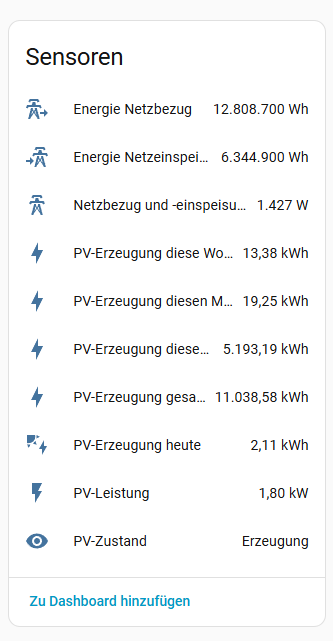

I started to pay for the data a few months before. With deleting and reintegration i see this now:
I know it becomes free now. So iI think that shall be available for all now…

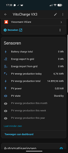

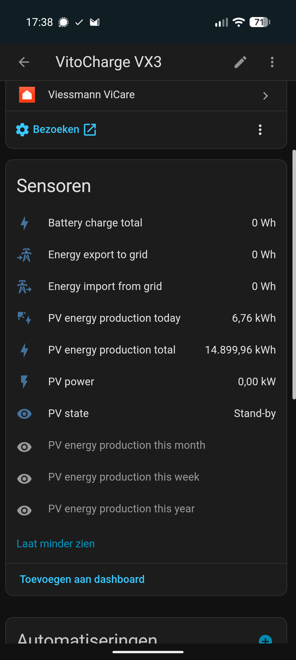

I deleted the integration and re-added with type set to auto as @Hafenstrand mentioned and that fixed the issue.
I can now see these entities:
Thanks for the help!
