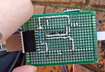

Well if anyone was interested, I found some time on the weekend to make a new board for my ESP32 chip to replace the ESP8266 chip that was on a breadboard (And yes I used single core cat6e cable to run the pool side).
Pool Acid - HX711 - Load cell (10kg)
Pool Level - JSN-SR20-Y1 - Waterproof dual-probe ultrasonic distance sensor
Pool Temp - DS18B20 - Dallas waterproof temperature sensor
