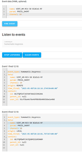

I am obviously blind at the Moment.
I really want to use the on-for feature of HM as well. Using a local “direkt Verküpfung” with a virtual button seemed a good idea.
I cannot find the virtual HM-RCV-50 in my devices list (all my homematic devices are entities) or in the entities.
So I tried at least to use the events: when firing the button on my raspberrymatic the switch works as planned, when firing the same from HA nothing happens:
  • Core2025.5.0
  • Supervisor2025.04.1
  • Operating System15.2
Raspberrymatic (virtualized) |Firmwareversion:|3.81.5.20250326|
Any idea or (idiot proof) trick how to get this to work or how to get the on-for x Seconds to work?
