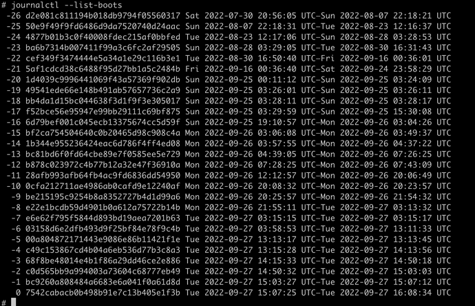

The other night the host crashed (I have not figured out why yet, it has never happened before).
Since then, HA has been acting strange. At first it started right up, but after a few hours it stopped responding. When I checked the console I saw this:
The end line here says “A start job is running for Docker Application Container Engine (4h 43min 20s / no limit)”.
I’ve seen this happen a few times now. In fact, HA has been restarting/needing to be restarted a lot recently:
I had also installed the Uptime Integration yesterday as I was suspicious of some logs. Now I’m seeing that HA core seems to keep restarting:
Some of these were me, but for example the last tiny sliver here is a restart that happened while I was typing this out.
I am SSH’d in to the HA VM (OS) and I didn’t lose connection, and checking the docker containers running I can see nothing has restarted - so it’s most likely a core crash/reboot for some reason…
I looked over many of the log files using journalctl, but I’m not really any closer to figuring out what is causing the problem.
I did see ZwaveJS having a lot of trouble
Some random sections of the logs from the first boot after the failure where I saw things that didn't look right, but could be completely expected, I don't know...
