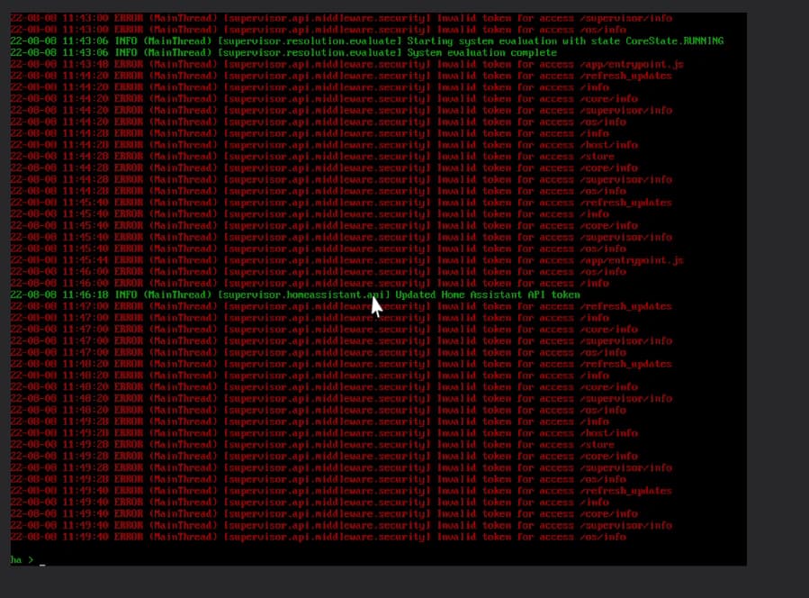

I gave this one last shot with Hyper-V. Same issue, there’s no container called “homeassistant”. And this is in the log output for docker logs hassio_supervisor:
