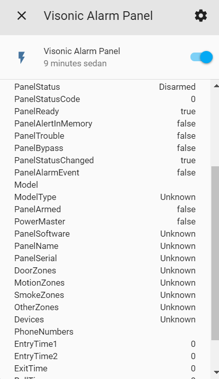

Now I have updated to latest version. I am still running in standard mode (else i don’t see any sensors). I have tested arm and disarm and it seems to work fine :slight_smile:
But in standard mode most of the information of the Panel says “unknown”
So Standard mode seems to be working as that is what I would expect.
There are 2 main benefits of Powerlink mode, you get to see all the information instead of “Unknown” and it automatically gets the user codes to arm and disarm the panel without you typing it in each time (but you could use the override_code in the configuration.yaml file).

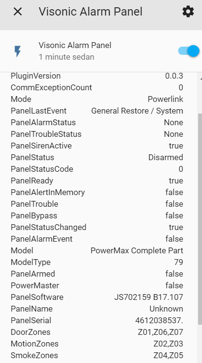

Something has happend. This time when I set force standard to “no” the sensors was there after reboot. I can arm/disarm and I can see when a sensor is trigged.
And I have the status for the Panel. I attach the log-file.force standard yes new.log.yaml (562.7 KB)

hypernative: From looking at your screengrab and the log file it has gone in to powerlink mode :grinning:
If you look through the log file you’ll see this about every 30 seconds from the panel:
It shows that the panel is sending “Powerlink Alive” messages, that is confirmation that the panel sees us as a powerlink device. The only thing that slightly concerns me is that my plugin doesn’t understand the code from the panel for the PanelName, it is “Unknown”. This is the detailed description of the panel type.
The panel sends updates using A5 and A7 messages and the sensors in HA are updated immediatelly, they do not wait for the next 30 seconds. This only prints them to the log file every time it receives the “Powerlink Alive”
When triggered is 1, then I put “T” in the sensor. When Status is 1, then I put “O” in the sensor. Essentially I only pass on the information that the panel tells me.

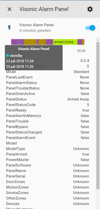

Something else I noticed: The panel sometimes changes its state to “standby” without having disarmed or armed in between…I have noticed this in all states. This state lasts for about 2 minutes everytime.
Any idea?
I’m pleased it works now and that you’re OK with using it in Standard mode.
For Powerlink, I suggest you leave force_standard set to ‘no’. At some point in the future when you restart HA it might connect in powerlink. The only down side of doing this is that the components in HA will take about 4 minutes longer to appear while it tries to make the powerlink connection (for 3 times) and then reverts to standard anyway.
I’ve never seen “standby”, can you be more specific which parameter name is it exactly. The only way for me to look at this further is for you to upload a log file.
The standby mode is actually the panel status…so where it should be: “Armed”, “Disarmed”, its now “Standby”.
I’m not sure if i restarted HA at this point and that this status is related to the component initializing. I enabled the debug logs en will let it run for a while (hope the log wont get too big).
Yesterday evening I couldn’t arm or disarm the panel suddenly (resulting in my neighbours waking up because of the siren :)), I didn’t have time to troubleshoot or reboot, and this morning it was working again…really weird.
Lets see if the debugs can capture that situation again.
Edit: Ok, had the same issue again today. Coming home and the component won’t let me disarm…seems that once I open a door the panel goes to ‘unknown’ state (I guess in standard mode it doesn’t know the entry delay state, or it’s just not in the code). This removes the option to disarm the panel. So I can only arm or disarm when no triggers are active when armed.

This is what I was looking for! :))) I can’t test it until next week but… I assume that with the Powerlink2 will work, right? Or do I need the TCP adaptador linked in the Github?
So I can explain this one. It should only happen on startup and it is the default state of the generic alarm part of HA until I set it to something. I can’t set it to something (other than “standby” or “unknown” or something like that) until the visonic alarm has told me what it’s state is. When “force_standard” is “yes” it should only appear for a few seconds, when force_standard is “no” then it may be there for longer while it negotiates powerlink mode and then passes or fails. Does it appear without restarting HA? I can see that your panel is Armed Away, I wonder if that has something to do with it.
For the “seems that once I open a door the panel goes to ‘unknown’ state”, I need to check that as it is not something I’ve tested. I disable my alarm from outside before entering with a keyfob and only enter once disarmed.
I think the standby was indeed related to HA restarts, been playing with my config so I probably restarted a few time, but didn’t relate this to the standby status.
