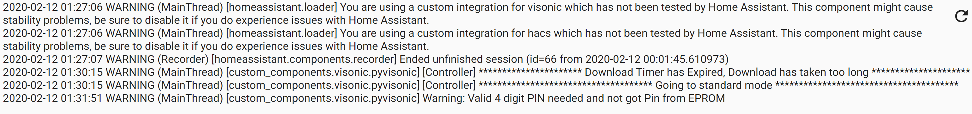

I have tried different alternatives for download_code but it doesn’t seem to do any difference what I put in there or even I comment it out it get stuck downloading the EEPROM and then goes to standard mode, where I have no devices at all except for the panel but I can’t see the status and says unknown
Once in a blue moon I see the Valid 4 digit pin needed error.

Hi, I think I might have started the download log file service to early after a reboot of HA because when I tried it again this morning it is all working fine and the files are created in the config directory.

Delete the entry from your config file completely. You do not need to set the download code.
However, looking at your log file there is no data being received from your panel. You either have the hardware setup wrong or you’re using the wrong comm port.
