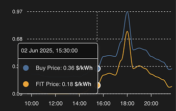

Thanks a lot for sharing the code. I modified it to show 2 decimal places on the tooltip
graph_span: 12h
span:
  offset: +12h
apex_config:
  float_precision: 2
  legend:
    show: false
  tooltip:
    enabled: true
    x:
      format: dd MMM yyyy, HH:mm:00
    "y":
      formatter: |
        EVAL:function(value, { series, seriesIndex, dataPointIndex, w }) {
          let buyPrice = series[0][dataPointIndex] || 0
          let fitPrice = series[1][dataPointIndex] || 0
          if (seriesIndex === 0) {
          return '<div class="custom-tooltip">' +
          '<span style="font-weight: 400;">Buy Price: ' + buyPrice.toFixed(2) + '<b> $/kWh</b></span>' +
          '</div>';
          } else if (seriesIndex === 1) {
          '<span style="font-weight: 400;">FIT Price: ' + fitPrice.toFixed(2) + '<b> $/kWh</b></span>' +
          '</div>';
      title:
        formatter: |
          EVAL: function(seriesName) {
            return ""
  xaxis:
    tooltip:
      enabled: false
all_series_config:
  stroke_width: 1.5
yaxis:
  - id: first
    decimals: 2
series:
  - entity: sensor.general_forecast
    type: line
    color: "#44739e"
    data_generator: |
      const forecasts = entity.attributes.forecasts;
      const result = forecasts.map(e => [
        new Date(e.start_time).getTime(),
        parseFloat(e.per_kwh || 0)
      return result;
    type: line
    color: orange
    data_generator: |
        parseFloat(e.spot_per_kwh || 0)
      return result;

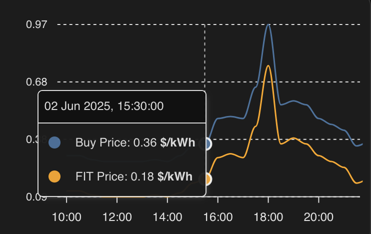

Thanks all for this thread. It solved my desire to graph the Amber Price Forecasts.
A few improvements - removing the values from the legend, that seem to be spurious.
Also since 5 minute price forecasting is now active for the next 2 hours, the forecasts array length is now variable and this does some odd things with the graph span and offset. I just set it all to 4h which gives a reasonable graph. The right-hand tail moves around a bit depending on where in the first hour you are.
type: custom:apexcharts-card
graph_span: 4h
span:
  offset: +4h
header:
  show: true
  title: Amber Electric Price Forecasts
  show_states: false
now:
  show: false
  label: Now
apex_config:
  float_precision: 2
  legend:
    show: true
  tooltip:
    enabled: true
    x:
    "y":
      formatter: |
          '</div>';
          '</div>';
      title:
        formatter: |
            return ""
  xaxis:
    tooltip:
      enabled: false
all_series_config:
  stroke_width: 1.5
yaxis:
  - id: first
    decimals: 2
series:
  - entity: sensor.your_general_forecast
    type: line
    color: "#44739e"
    name: Buy Price $/kWh
    float_precision: 2
    show:
      legend_value: false
    data_generator: |
      return result;
  - entity: sensor.your_fit_forecast
    type: line
    color: orange
    name: FIT Price $/kWh
    float_precision: 2
    show:
      legend_value: false
    data_generator: |
      return result;

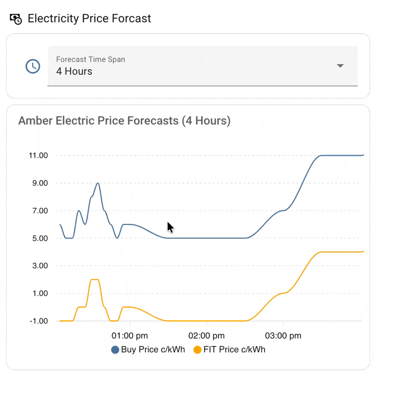

I got a bit OTT with it, and created a customisable dropdown set of graphs so you can easily cahnge between 4/8/12/24 hours forecasts, along with options to mess with colours.
Warning! Use at your own risk - I’m very new to HA!
I should probably stick this on github, but for now, comprehensive instructions in the code; then just copy and paste the yaml.
HA Amber price graphs

type: vertical-stack
cards:
  # Dropdown selector for time span
  - type: entities
    entities:
      - entity: input_select.amber_chart_time_span
        name: Forecast Time Span
  # 4 Hour Chart
  - type: conditional
    conditions:
        state: "4 Hours"
    card:
      graph_span: 4h
      span:
        offset: +4h
      header:
        show: true
        title: Amber Electric Price Forecasts (4 Hours)

      series:
        # REPLACE THE SENSOR NAMES BELOW WITH YOUR OWN!
        - entity: sensor.REPLACE_ME_general_forecast
          type: line
          color: "#44739e"
          name: Buy Price c/kWh
          float_precision: 2
          show:
            legend_value: false
          data_generator: |
              parseFloat(e.per_kwh || 0) * 100
            return result;
        - entity: sensor.REPLACE_ME_feed_in_forecast
          type: line
          color: orange
          name: FIT Price c/kWh
          float_precision: 2
          show:
            legend_value: false
          data_generator: |
              parseFloat(e.spot_per_kwh || 0) * 100
            return result;

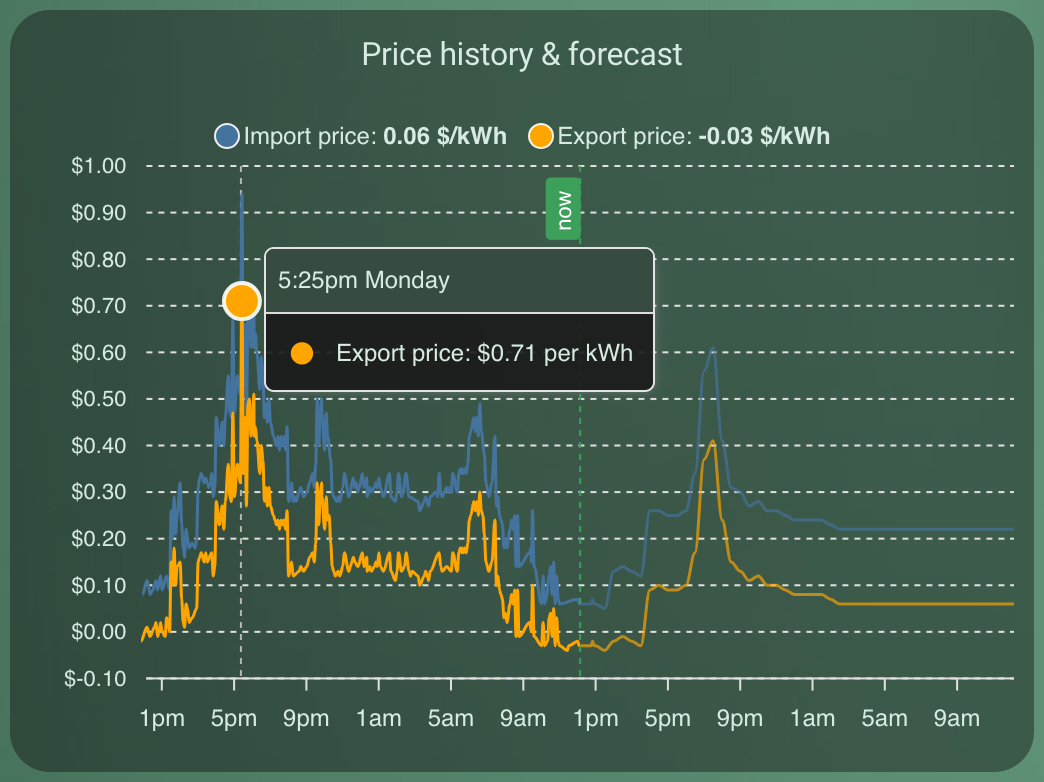

Thanks everyone in this thread for putting the pieces together.
One question I have is why people are using spot_per_kwh for FiT forecasts? My understanding was that per_kwh is more accurate as it includes other costs involved. Please correct me if I’m wrong!
I also wanted to add the price history to the chart and make some design tweaks to match my personal preferences and setup. Sharing the code here if anyone is interested. The only problem is that the tooltip no longer shows shared values, which I believe is because of the irregular timeseries involved. Potential solutions which I pursued but couldn’t get working: this and this.
header:
  title: Price history & forecast
  standard_format: true
graph_span: 2d
span:
  offset: +1d
now:
  show: true
  label: now
apex_config:
  float_precision: 2
  legend:
    show: true
    position: top
    floating: true
    customLegendItems:
      - Import price
      - Export price
  tooltip:
    enabled: true
    x:
      format: h:mmtt dddd
    "y":
      formatter: |
            '<span style="font-weight: 400;">' + w.config.series[seriesIndex].name + ': $' +(series[seriesIndex][dataPointIndex] || 0).toFixed(2) + ' per kWh</b></span>' +
            '</div>';
      title:
        formatter: |
            return ""
  xaxis:
    labels:
      format: htt
    tooltip:
      enabled: false
all_series_config:
  stroke_width: 1.5
yaxis:
  - id: first
    align_to: 0.1
    apex_config:
      labels:
        formatter: |
          EVAL:function(value) {
            return "$" + value.toFixed(2);
series:
  - entity: sensor.electricity_general_price
    type: line
    color: "#44739e"
    extend_to: now
    float_precision: 2
  - entity: sensor.electricity_feed_in_price
    type: line
    color: orange
    extend_to: now
    float_precision: 2
  - entity: sensor.electricity_general_forecast
    name: Forecast import price
    type: line
    color: "#44739e"
    opacity: 0.67
    data_generator: |
      return result;
  - entity: sensor.electricity_feed_in_forecast
    name: Forecast export price
    type: line
    color: orange
    opacity: 0.67
    data_generator: |
      return result;
