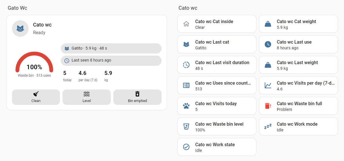

My cat uses a Vividmoo (UBTech “airpet”) self-cleaning litter box, and the only way to see what it was doing was the official phone app. So I reverse-engineered the app and wrote a Home Assistant integration for it. It’s been running in my house for a while, so it’s time to share it.
What it does
Everything the app shows, now in HA:
  • Waste bin: fill level, uses since you last emptied it, and a “bin full” alert
  • Visits: the last one (which cat, weight, how long, when), visits today and the 7-day average
  • Cat weight as a long-term statistic, so you can watch it over months. It only counts visits where the box identified the cat, so the graph doesn’t spike.
  • Box status: idle / cleaning / leveling / paused / blocked
  • Cat inside: the box reports in real time when the cat steps in and when it leaves. This is my favourite one for automations, for example “never start a clean while someone’s in there”.
You can also control it: Clean, Level litter, Pause, Resume, and “Waste bin emptied” to reset the counter.
A card included
The integration serves its own dashboard card, so there’s no extra resource to install:
type: custom:vividmoo-card
device_id: <your litter box>
The card has the bin gauge, the last visit, today’s numbers and the buttons. During a clean it shows a spinning drum with a progress ring, timed from what the box actually reports. Tap any value to open its history.
