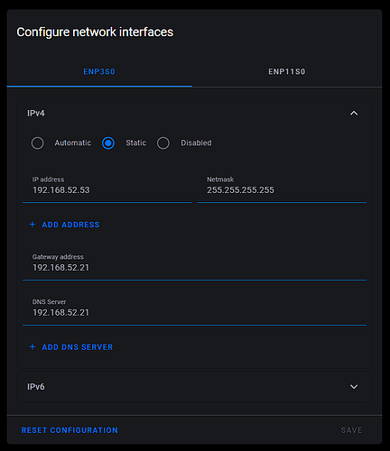

OK, so in this case it should work with 8123 port open for IP address you can access HA from local network. As it is bridged network, your VM should get VM specific IP address. You can check it from WMware, console view of your HA (disregard second IP on my screenshot, I have 2 NICs configured):
