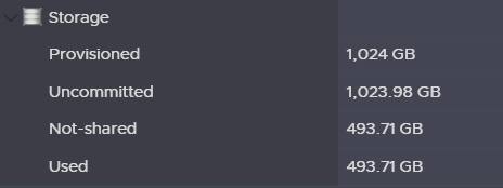

My HAOS system has been running fine for years in VMWare, I have recently noticed the VM has got huge despite despite only about 70-80gb used:
The VM is nearly 500gb and my VM backups are the same!

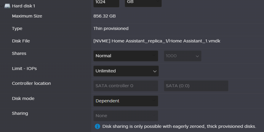

How is your VM storage configured in ESX? What storage browser shows for this particular file?
It is set as thin provisioned this is what the browser shows for the VMDK:
This is explained on the Broadcom support site:
Deleting data from Guest OS only removes the data from the file allocation table but does not zero the blocks. As a result, the ESXi Host still sees the blocks in use even after deleting the data.
Reclaiming disk space from thin provisioned VMDK files when ESXI Host still sees blocks even after removed from GuestOS

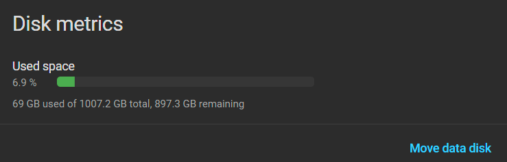

Your screenshot shows 69GB, but the sizing is up to you. There is nothing to be wary about, you don’t need to delete the original vm until you are satisfied the result is what you want. Just turn it off.
