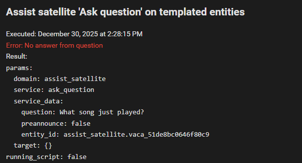

Is there a way to require the user answer? Right now if no answer is given the automation stops. Is there a way to continue?
Short of that, can the response variable be checked for null/empty and then prompt the user again via another call or just say something like “time is up” and continue the automation flow?

Thank you for this info! Is this documented somewhere? I had a hard time finding info outside of on the voice assistant page.
Can I determine if an error occurred so that I can handle it? I can do something like check the response variable is empty to determine if no response was given?
Try to see what the song_guess.sentence variable returns. I haven’t tested it, but I think you’ll be able to do the check.
