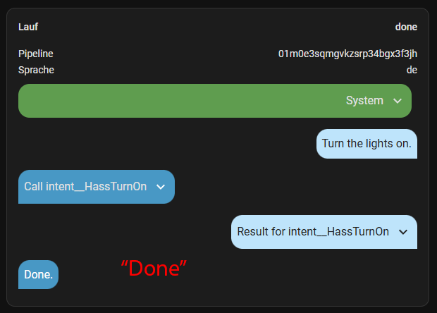

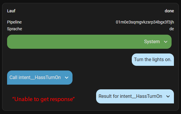

Older models, in particular, would execute commands (Call intent__HassTurnOn) and then respond with something like “The light is now on” or “The garage door is now open” (or, in the example below, simply “Done”).
Most newer models, however, sometimes respond differently. Yes, sometimes they, too, provide a text response at the end, but sometimes they execute their tools and then stop. Home Assistant can’t handle this, though, because it expects a text response (see first image). No text response = “Unable to get response,” which is nonsense, since the tool/task was completed beforehand, the AI just didn’t “think” it necessary to confirm it again (which makes sense; I can see when the light turns on, so I don’t need to get that as a response).
So the problem isn’t a faulty response, but simply that Home Assistant can’t handle it when no text is returned in the Assistant pipeline.
