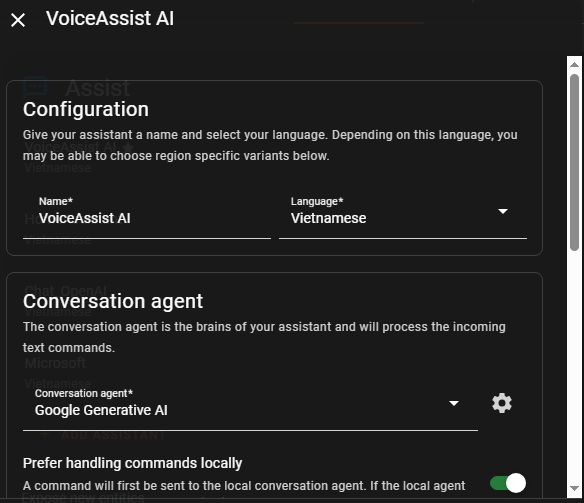

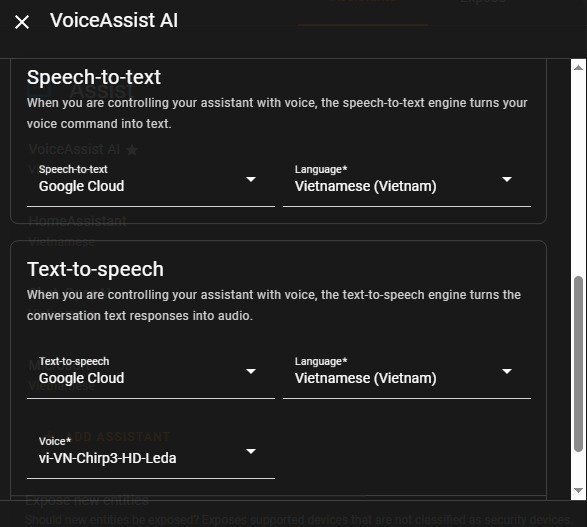

what conversation agent are you using? do you have nabu casa subscription?
if you are using piper try with Homeassistant cloud

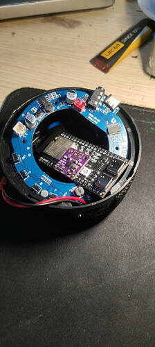

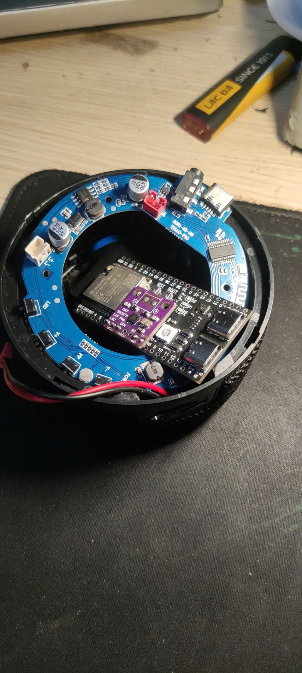

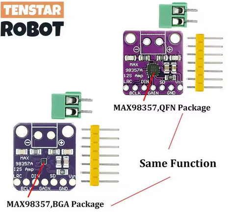

There is difference between the Max98357 and the one voice PE is using, I don’t have the issues you had, and a made multiple assist, the only thing i think can be different is the DAC maybe from different manufactures there are two versions with different chip one is QFN package and the other is BGA package, not sure if that is cause of a problem, but did you try changing the buffer_duration on the speaker?
Oh, I haven’t tried what you said - to clarify I’m using DAC - QFN as in the picture. And the problem only appears on your latest V4 version. Previous version like V3 is completely normal.
