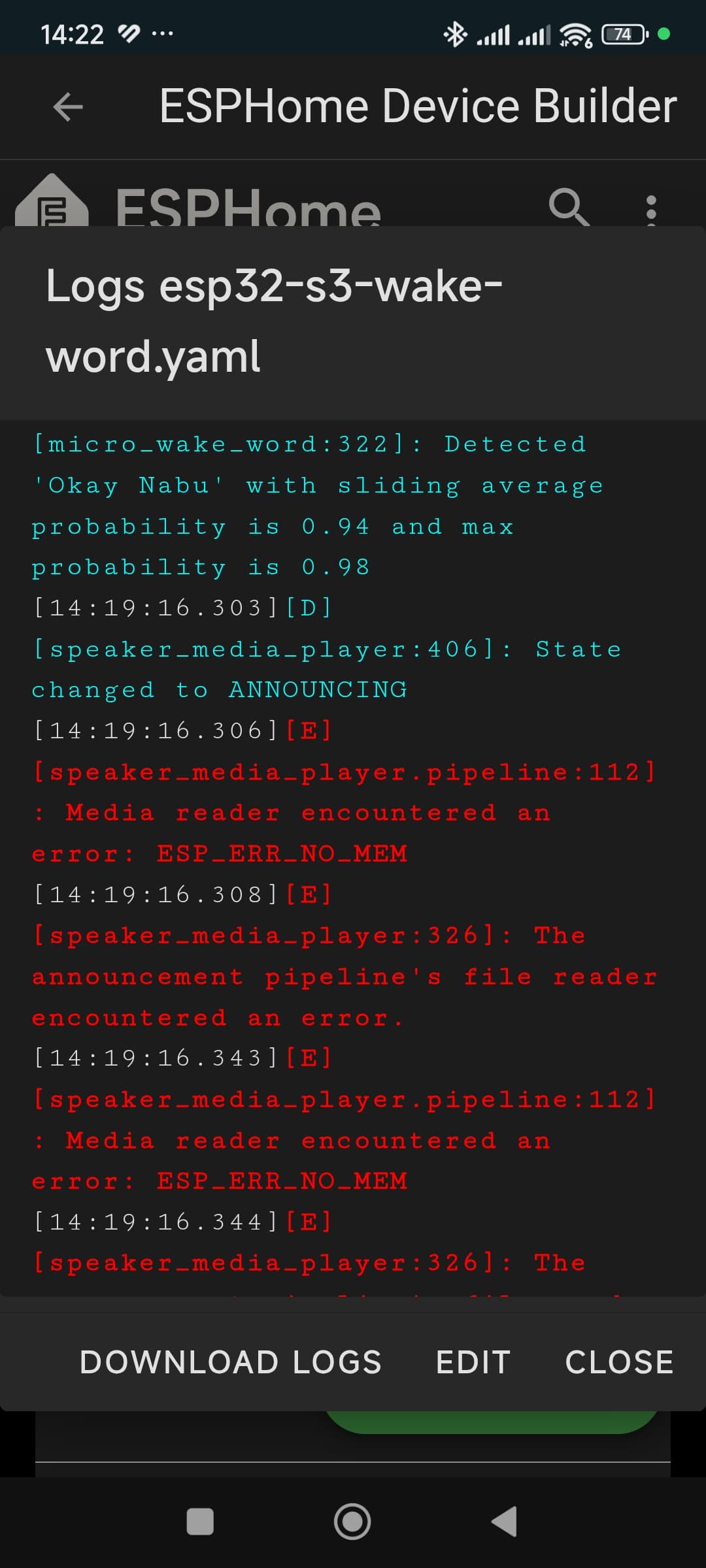

I have an ESP32-S3 N8R2. Probably, the memory is too low, so the V3 does not work. In fact, Ok Nabu and led lights are working well, but I have no response from the speaker.
I’m not a specialist… but…
the PSRAM in the base YAML is set to:
psram:
  mode: octal
  speed: 80MHz
maybe you have to change it:
psram:
  mode: quad
  speed: 80MHz
(Line 156)
(quad for N8R2 and octal for N16R8… maybe someone will be able to help you better)

I tried with quad, too. Same situation, unfortunately. I just ordered a N16R8 ESP32-S3 board. Thank you for pointing to my mistake.
