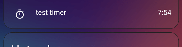

I am using a diy voice assisant and I am able to set timers with it. These timers are running on the esp32 device. For now I have a text_sensor in HA under the esphome device that show the remaining time of the timers. This far all good. But I can start 2, 3 or more timers at ounce and I would like to track their progress in HA. The tricky part is that I don’t know how many timers there will be running so I was thinking to only display a test_sensor in HA for each active timers or none if there are no timers running. Is there a way of doing this? And if so could you give me some pointers to look into. Thanks

Why not use the built in Timers now that they are out with the July release, if your not already doing so. I don’t think a text sensor would have to be manually created. You can name timers to run multiple ones. I believe you just have to use the voice phases similar to the S3 box. That’s what I’ve been doing although I haven’t updated my config for native timers yet on my voice assistant. The first part is from substitutions and be part after is the first script for native timers.
Now having them display in the HA app, that I’m not sure about as I just ask for the time remaining via voice using my jank automations solution for 2 timers at once. This involves creating a timer via helper and I had to create a text sensor for remaining time because for some reason the only way I could get that value was to pause the timer, store value, then resume immediately (I’m sure there is a much better way of doing this)but even that was based on some even older Rhasspy code I had used. You can also do stuff like the below with the new native solution.

The thing is that if I have multiple timers running in forget which one are running. I could give them a name to start with but I like to see how much time each one has left and to add/subtract time or even cancel the right one. For that I like to have an overview in HA. I could make text sensors as 10 placeholder but I was hoping to do that a bit more dynamically based on the timer.size() call.

Here is an example to update the text_sensor directly
- id: active_timer_widget
then:
- lambda: |
id(check_if_timers_active).execute();
if (id(global_is_timer_active)){
id(fetch_first_active_timer).execute();
int hours_left = floor(id(global_first_active_timer).seconds_left / 3600);
int minutes_left = floor((id(global_first_active_timer).seconds_left - hours_left * 3600) / 60);
int seconds_left = id(global_first_active_timer).seconds_left - hours_left * 3600 - minutes_left * 60 ;
auto display_hours = (hours_left < 10 ? "0" : "") + std::to_string(hours_left);
auto display_minute = (minutes_left < 10 ? "0" : "") + std::to_string(minutes_left);
auto display_seconds = (seconds_left < 10 ? "0" : "") + std::to_string(seconds_left) ;
std::string display_string = "";
if (hours_left > 0) {
display_string = id(global_first_active_timer).name + " " + display_hours + ":" + display_minute;
} else {
display_string = id(global_first_active_timer).name + " " + display_minute + ":" + display_seconds;
id(text_timer).publish_state(display_string.c_str());
+2 for this!!! And make timers work with ViewAssist
As far as what’s displayed in HA this can be done with conditions when creating the HA dashboard. You could create 10 text sensors than only have active ones show up in the HA dashboard. See the below where he has the dashboard update dynamically to the room he’s in using a condition based on the esprense location and has some other examples like the garage door status only showing when it’s open since it’s closed most of the time. If your main goal is not to have 10 text sensors showing up when only one timer is running in the HA dashboard this should accomplish that. This way you can show no timers or just active ones.

Yesterday I made a few long running timers (10h +) om the ESP. This morning the where not available anymore on the ESP. Probably due to some connection problems, a restart or what else. I didn’t look into that yet. But to my surprise I noticed that these timers where still running in HA. For that i opened Assist and ask for “Timer Status”. It told me that 3 timers where running and gave details of the one with the shortest time left. In HA I wasn’t able to trace these timers. I used dev tool for it but they didn’t show up. I may be overlooking here something.
