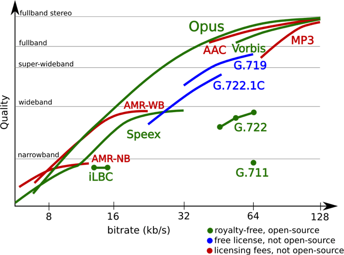

In the livestreaming thay said that they use the opus codec for an higher quality and bandwidth, but with the G.722 codec we can achieve a similar quality to the OPUS codec, as shown in this graph (Note that the red SWS Signal is referred to the X highest codecs “Such as OPUS”)
So I think there is somehow a solution to the OPUS problem, or not?
No not really (though it may be sufficient)
Also opus is lower latency, licensing is free and open source and transcodes better from G.711.
