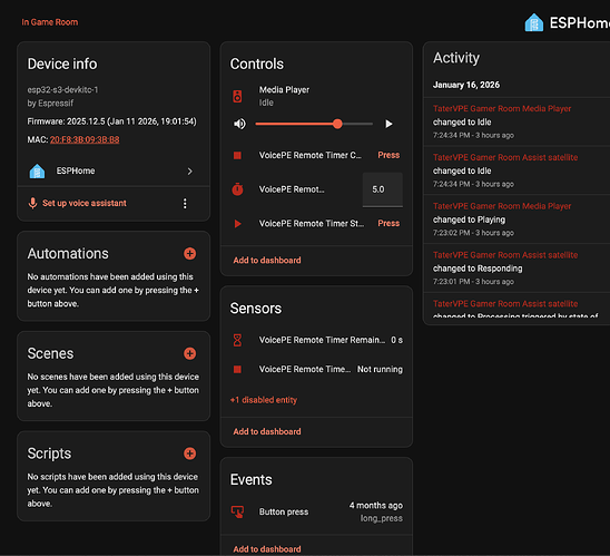

So I needed a reliable way to trigger timers on the Voice PE without going through the Assist / voice pipeline.
The built-in Assist timers only work when the device itself starts the conversation. You cant trigger it externally (from automations, scripts, or tools)
So I updated the Voice PE ESPHome configuration to expose a device-local timer.
With this update:
β€’ The timer runs entirely on the Voice PE itself, matching the behavior of the built-in timer.
β€’ The LED ring shows a smooth, local countdown
β€’ Ringing and cancel behavior are handled on-device
β€’ Home Assistant (and tools like Tater) act only as a remote control
might be useful to anyone that needs voicePE timers you can trigger from automations, dashboards, or external tools
