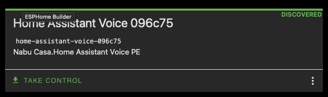

I have now re-added it. Should I take control of the device. I have the green screenshot above. The phone took a long time checking for updates, but Home Assistant sees it needs 25.4.0 from 25.3.4. In fact, I updated it via web page and the phone the reflected it was updating.
I haven’t had a chance to test it yet, but it has been re-added and up to date.
No. You only take control if you want custom code. Using default is simpler

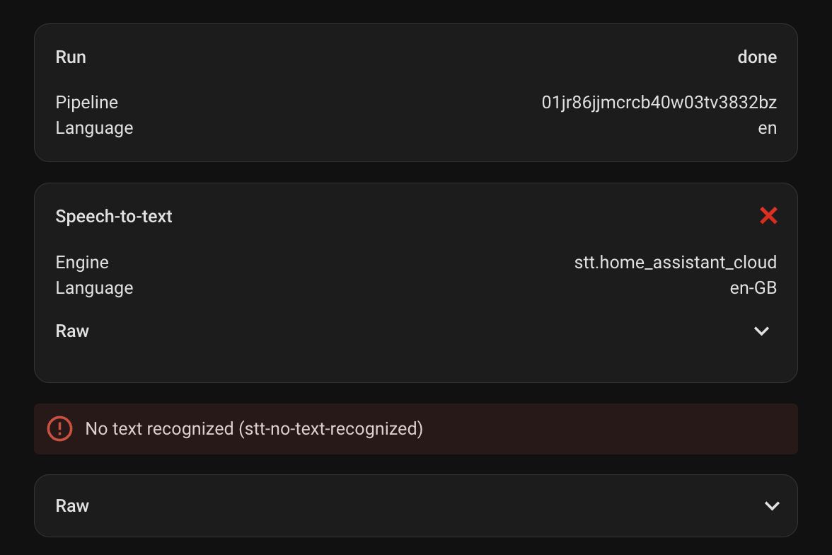

Some further investigation. I noticed this which is what I think you were talking about before.
I switched it from Home Assistant Cloud back to local. Still no voice response, but after switching it back Home Assistant Cloud I now get this, but with no response.

Regarding the first screenshot
Do you have look Speech to Text provider setup? Rhaspy or I think faster-whisper is other option.
Cloud works but your HA voice probably can’t reach HA at “local network” address
Local has STT fail and probably also “local network” issue

The STT screenshot came from the same debug screen. That issue seems to have gone away. The last screen shot is from the same debug screen. This is my configuration.
