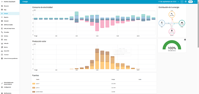

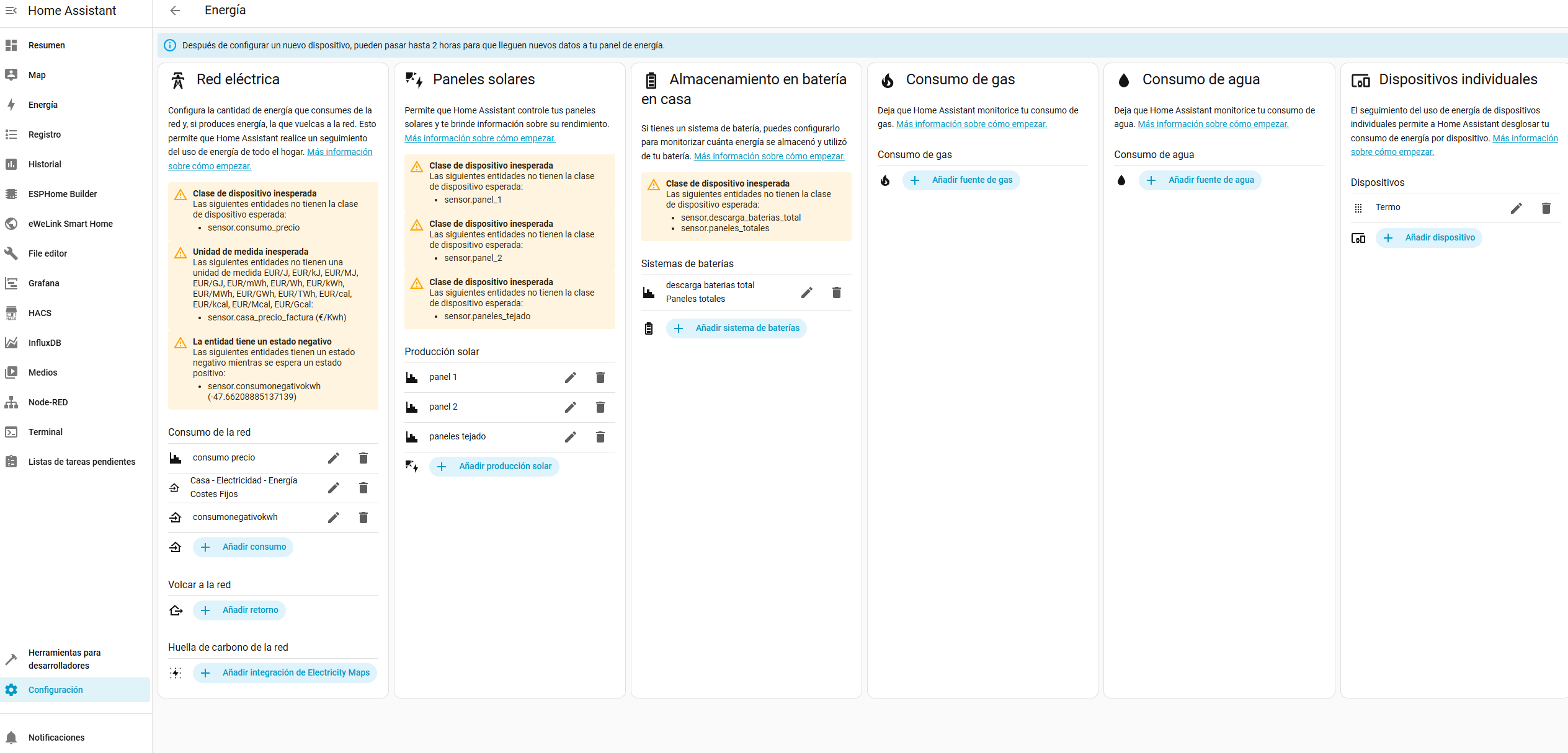

I have a voltronic inverter with off-grid panels and batteries, in the energy panel I put all the data they ask me for, in the GRID panel I have put some templates to simulate the consumption I have at home with prices and thus get the daily price, then I have put the consumption in negative again so it subtracts it from the HOME box, in the battery option I put the solar production and the battery discharge, now I get in the HOME box what I discharge from the battery but I do not get the direct consumption from the solar panels to HOME which is in yellow
Remove that.
In the battery I put what goes into the batteries that are the solar panels and what comes out is the battery discharge. If I remove what goes in, I am left without a battery.
If all your PV energy is going into your batteries then none is consumed by your home.
You need to provide a sensor that indicates the amount going in and a sensor that indicates the amount coming out of your battery.
If all of your PV energy is not consumed by your battery then the total solar energy sensor is the incorrect one to use for the amount of energy going in to your battery.
Thank you very much, it worked for me. Do you know if there is a way to make sure that the consumption I enter on the grid to calculate the bill and the negative consumption on the grid do not appear in the hourly consumption bar graph?
No, that is what the top graph is for.
