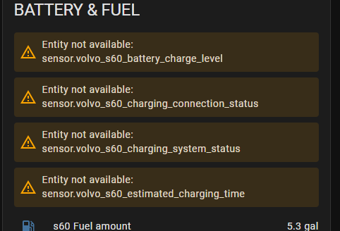

I had to uninstall, wait, then re-install. It worked for me then but I was missing some entities related to battery charge status and level.

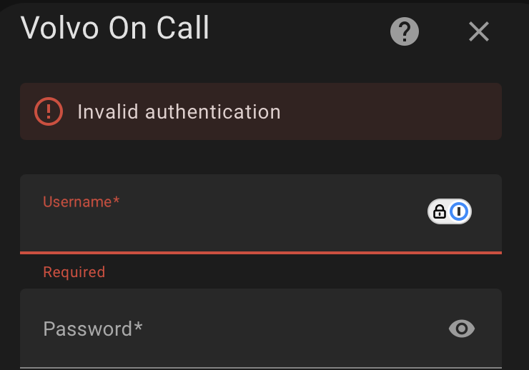

This is a screenshot of Volvo On Call. That doesn’t work anymore.
If you want to have your Volvo in HA, you’ll need to install my custom integration “Volvo Cars” which uses their new API. See opening post for details.

Please see Recharge Battery Level Missing in 1.4.3 · Issue #111 · thomasddn/ha-volvo-cars · GitHub
Thanks. Volvo issue.

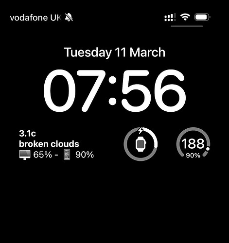

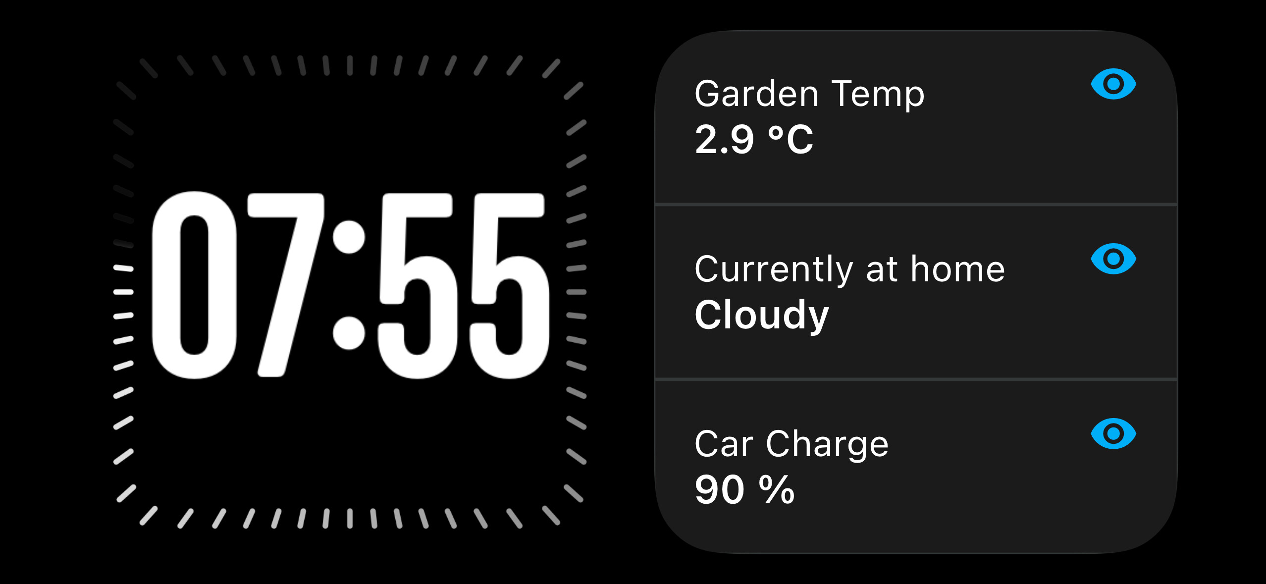

Thanks for this great add-on. I have it working with my EX30 and as well as the usual HA dashboards and information, I have setup to show information on my iPhone nightstand and Lock Screen showing charge % and range (miles).

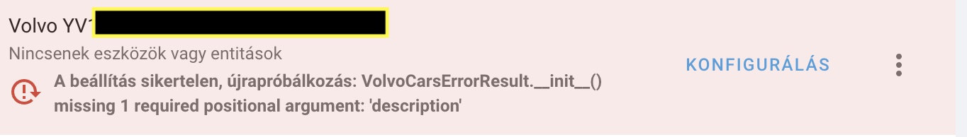

I need help with this, why am I getting this?
The API returns an error, but due to a bug in parsing the error message, the error could not be shown properly. However, you should have some more details in the logs of Home Assistant. Can you check if there is something relevant?
The error parsing bug has just been fixed in v1.5.0.
Ez a hiba egy egyéni integråcióból szårmazik.
NaplĂł: custom_components.volvo_cars.coordinator
ForrĂĄs: helpers/update_coordinator.py:319
integråció: Volvo Cars (dokumentåció, problémåk)
ElƑször fordult elƑ: 22:06:34 (3 EsemĂ©nyek)
UtoljĂĄra naplĂłzva: 22:06:50
Unexpected error fetching 01JP2X66E7P5X9A32AA97G55HZ data
  File "/config/custom_components/volvo_cars/volvo/api.py", line 232, in _async_request
    response.raise_for_status()
  File "/usr/local/lib/python3.13/site-packages/aiohttp/client_reqrep.py", line 1161, in raise_for_status
    raise ClientResponseError(
    ...<5 lines>...
aiohttp.client_exceptions.ClientResponseError: 401, message='Unauthorized', url='https://api.volvocars.com/connected-vehicle/v2/vehicles/XXXXXX'
  File "/usr/src/homeassistant/homeassistant/helpers/update_coordinator.py", line 319, in __wrap_async_setup
    await self._async_setup()
  File "/config/custom_components/volvo_cars/coordinator.py", line 113, in _async_setup
    vehicle = await self.api.async_get_vehicle_details()
  File "/config/custom_components/volvo_cars/volvo/api.py", line 141, in async_get_vehicle_details
    data = await self._async_get_data_dict(_API_CONNECTED_ENDPOINT, "")
  File "/config/custom_components/volvo_cars/volvo/api.py", line 175, in _async_get_data_dict
    body = await self._async_get(endpoint, operation)
  File "/config/custom_components/volvo_cars/volvo/api.py", line 183, in _async_get
    return await self._async_request(hdrs.METH_GET, endpoint, operation)
  File "/config/custom_components/volvo_cars/volvo/api.py", line 253, in _async_request
    error = VolvoCarsErrorResult.from_dict(error_data)
  File "/config/custom_components/volvo_cars/volvo/models.py", line 58, in from_dict
    return cls(**class_data)
TypeError: VolvoCarsErrorResult.__init__() missing 1 required positional argument: 'description'

It looks like you’re unauthorized. The integration should ask you to re-authenticate, but you might need to install v1.5.0 first.
