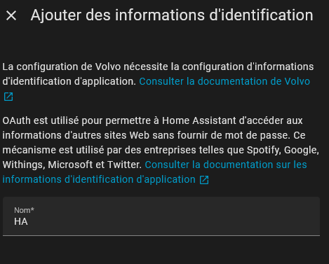

Once the client id and secret are set, I’m redirected to volvo and it fail.

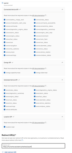

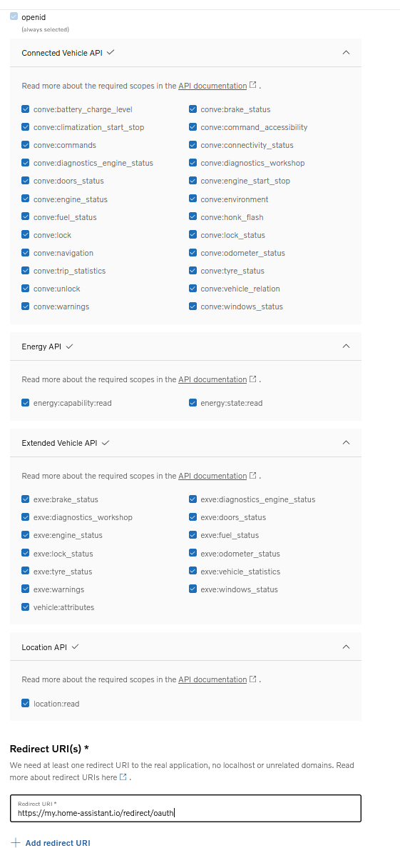

So you are using your own client id/secret? Have you selected all scopes and filled in the redirect url as mentioned on the documentation page?
Yes fully set like specified (Link to OAuth2 Authorize Callback – My Home Assistant), even tried to clean all my cookies but I continue to reproduce this error.

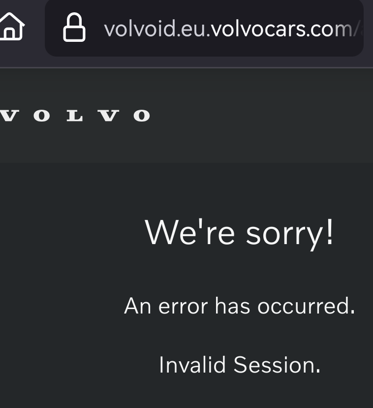

After some investigation, if I click on add, I’m redirected to volvoid.eu.volvocars.com/as/authorization.oauth2?response_type=code&client_id=dc-xxxxxxxxxxxx&redirect_uri=http%3A%2F%2Fmy_ha_instance

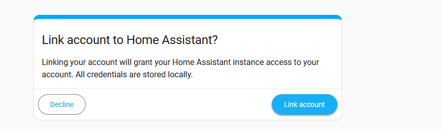

If I replace in the url the redirect_uri parameter by “redirect_uri=https%3A%2F%2Fmy.home-assistant.io%3A8123%redirect%2Foauth” and refresh, I’m redirected to:
If I try to click to “link account” (instance url is correct), I have this error on HA:
UPDATE: issue fixed, all goes wrong due to “my:” (to enable my redirect) was not present in configuration.yaml.

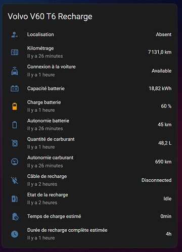

Can you share your yaml/resources needed to have this card? It’s really good!
EDIT: it’s done by the volvo cars custom integration available on HACS right?
