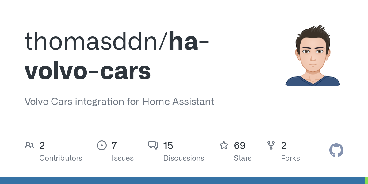

Since the integration was using an old deprecated API it will no longer work, it hasn’t been worked on for a while. In the issue thread on Github they linked a new integration that is currently in active development:

I run my HA in Docker and this was the way I was able to use my Volvo again:
  1. Follow the installation instruction to create new Volvo API from here
  2. I copied Volvo custom component from here to my Docker config folder
  3. Then I restarted my HA
  4. I searched then for the Volvo integration and filled in all the required field and confirmed.
  5. Then I waiting for the 6-digit number, which arrived into my mailbox. Then I confirmed all.
  6. Done. Enjoy :slight_smile:

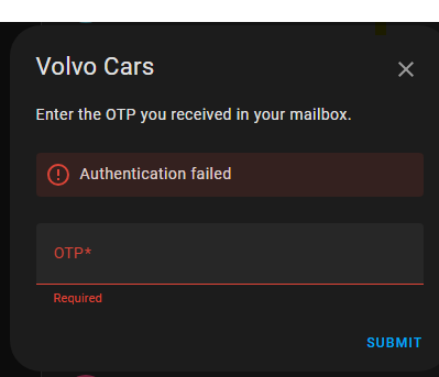

This morning my integration looked like this for my EX30 which now has digital keys and working mobile app but no Home assistant integration!
Oh and yes I did enter the code that arrived via email and this was the responce.
It took me a couple of tries. It did work thought. My problem is that my model XC90 isn’t supported for some of info, like location.
