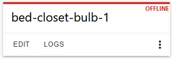

Now I’m stuck with this Error :frowning:
All I get is this. Anyone have any suggestions?
ESPhomeFail
ESPhomeOffline
ESPhome knows it’s on the network… Else it wouldn’t ask to config. it.
I know that you can download the diagnostics and get the ip from that, ESPhome Home assistant Integration, however it appears you haven’t been able to add it for it to appear in the list to generate that.
If you are using DHCP on your local network, a tool like Fing or logging into your router and checking the DHCP clients list may help you find it via IP address.
A static IP may help, however that can get tedious quickly with a bunch of bulbs.
If you can’t access the router and you don’t like the idea of Fing, then a nmap scan for the port 6053 will show you all the devices on your local network that use the API port for ESPHome.
How different is your yaml to the above guide? Is it possible the device isn’t on anymore?
DHCP servers renews IP address leases every X hours. It could be that the IP addresses changed due to a DHCP server setting if it fell within the window.

Update: It was able to be added to HA after flashing tasmota and esphome again.
