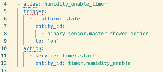

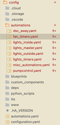

VS Code is showing erroneous errors in my yaml files. But only the files that are in a sub folder called ‘automations’.
The file association in VS Code is ‘home assistant’. I tried changing it to yaml, with no impact. I don’t think it is the yaml parser (not sure). I think it has something to do with the sub folder.
Any idea how to fix this?

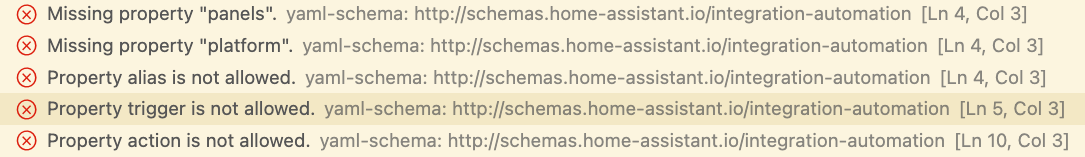

“resource”: “/Volumes/config/automations/fan_timers.yaml”,
“owner”: “generated_diagnostic_collection_name#1”,
“severity”: 8,
“message”: “Missing property "panels".”,
“source”: “yaml-schema: http://schemas.home-assistant.io/integration-automation”,
“startLineNumber”: 4,
“startColumn”: 3,
“endLineNumber”: 4,
“endColumn”: 4
“severity”: 8,
“message”: “Missing property "platform".”,
“startColumn”: 3,
“endLineNumber”: 4,
“endColumn”: 4
“severity”: 8,
“message”: “Property alias is not allowed.”,
“startColumn”: 3,
“endLineNumber”: 4,
“endColumn”: 8
