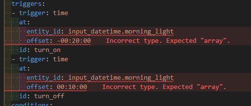

VSCode is throwing a fit with these two:
- trigger: time
at:
entity_id: input_datetime.morning_light
offset: -00:20:00
- trigger: time
at:
offset: 00:10:00
Incorrect type. Expected “array”.yaml-schema.
It was generated by HA automation GUI editor, I can’t see anything wrong with it at all.
It is also correct according to the docs:
Any idea how to stop VSCode from freaking out? Is there some minor edit I can do that is correct both for HA and VSCode schema?

In case it makes any difference, here is the full automation. I’ve looked at it many times, I can’t see anything wrong anywhere.
- alias: Aircon - Morning Bedroom Heating
description: ''
triggers:
- trigger: time
at:
offset: -00:20:00
- trigger: time
at:
offset: 00:10:00
conditions:
- condition: state
entity_id: sensor.home_presence_simple
state: home
actions:
- choose:
- conditions:
- condition: trigger
id:
- turn_on
Feels like I’m going mad, those red lines really bothers me.

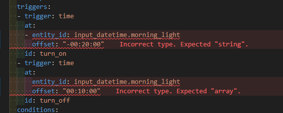

What happens if you quote the offset value?
- trigger: time
at:
offset: "-00:20:00"

It’s complaining about it not being a list/array. So this would likely fix it:
- trigger: time
at:
- entity_id: input_datetime.morning_light
offset: 00:10:00
wyx087
(Wyx087)
August 7, 2025, 6:15am
10
I get a different error adding a dash. Wrapping offset with quotes doesn’t seem to do anything.

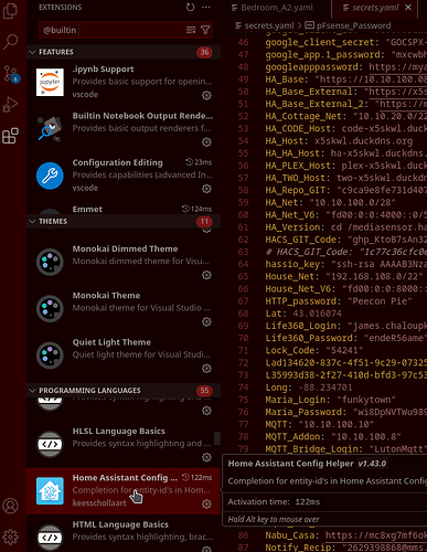

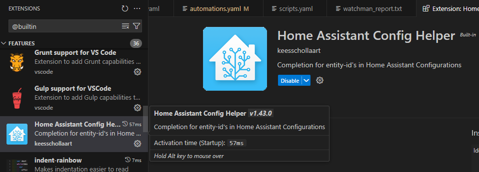

It comes bundled, but you can update it once it’s there.
tom_l
August 8, 2025, 10:20pm
14
It doesn’t even show up in my add-on.

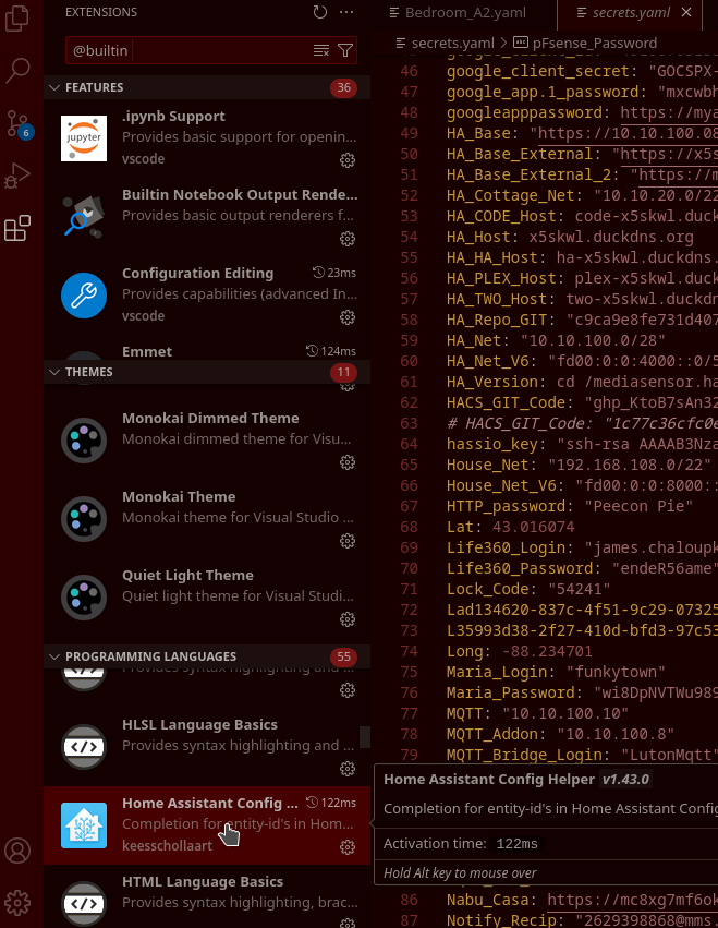

Click built-in… after you click the filter symbol under extensions.
tom_l
August 9, 2025, 3:17am
16
Ah. That’s where it’s hiding. Thanks.
wyx087
(Wyx087)
August 9, 2025, 7:24pm
17
How do I update it?
Looks like I have the same version as you though.
Presumably v1.43.0 is the latest?
