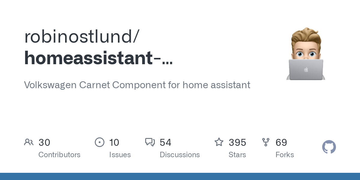

How did you get the data from your ID.4 into HA? I have an ID.4 and have yet to figure out an integration into HA.
Hi Brian,
I’m using this HACS Component:
Works great (at least in EU).

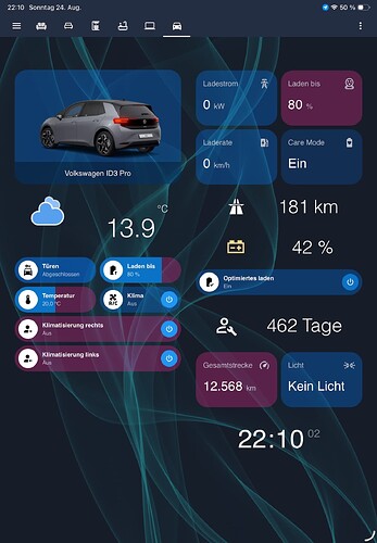

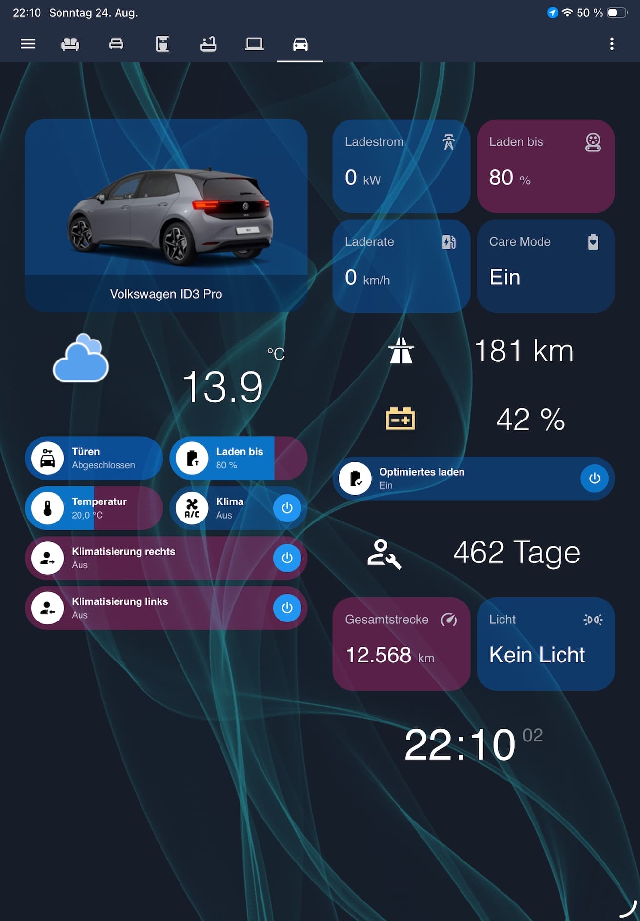

I have a VW ID3 and created a dashboard for my iPad. I implemented it using the Volkswagen Connect integration. The theme is Noctis. I used the following cards: picture entity with card mod, entity card with card mod, custom weather card, custom button card, clock card, and bubble card.
