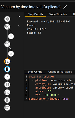

Any ideas what I’m doing wrong? Tried without continue on timeout, without for: 00:00:01 as well
continue_on_timeout: true is worthless if you haven’t specified a timeout. If you didn’t provide a value for timeout then it uses the trigger(s) exclusively.
You’re using a Numeric State Trigger which will trigger only when the battery_level increases and crosses the threshold value of 25. According to the trace, it’s currently 63 so it won’t trigger (because it already exceeds the threshold value).
The only way that will trigger is when the battery_level is below 25 and increases above 25.
If that doesn’t answer your question, post the entire automation so we can understand what you are trying to accomplish.
