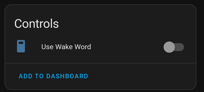

Do I need to update my HA somehow to test this new setup, I kept getting errors even when I turned off use_wake_word template button.

But itâs right theeere!
Itâs working awesome with my atom echo and âhey nabuâ using openWakeWord! Sweet!

How did you get this option?
I configured openwakeword and also set in the assist pipeline. But I donât see this option in the entity
