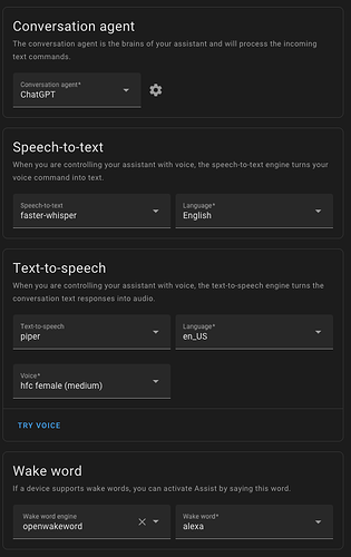

took me a while to figure out how to get the m5stack atom echo working as i don’t have a typical HA installation. i run HA in a vm on proxmox. there are definitely some critical pieces of info missing from most of the guides on how to get the atom echo working - like the yaml config of the device in esphome is very specific. anyway, once i figured that out, most of the integrations started working. however, the “use wake word” and “use listen light” toggles are disabled and i can’t seem to figure out how to enable them. it’s working as i would expect when the button is pressed. anyone know what i’m missing here?
firmware is: 2024.5.5
i’m using this config for the device: firmware/voice-assistant/m5stack-atom-echo.yaml at f9290e1925a3840ef5fc43a5ec5dcb2c704b2d7f · esphome/firmware · GitHub
and here’s my assistant config:
