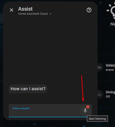

On my Windows 10 machine, I am able to navigate to my HA front-end in a browser and click the little assist button in the corner, and then click the microphone to send a voice request to HA Assist. Is there a way to do this with a wake-word if I just leave my browser open? And if not, what’s stopping that functionality from happening? Is it a security issue with allowing a browser constant access to the microphone or something else?

Home assistant web UI already has a button for listening that doesn’t work on http which means that its not against any rules or practices to allow microphone support for those who have https enabled.

I am implementing the wake word function in my HA running on a windows 11 virtual machine, I managed to get the PC microphone to work via http chrome browser by unlocking the protection for the homeassistant.local site by activating “flags/#unsafely-treat-insecure-origin-as-secure”.
then by pressing the microphone button in Assist I can give commands very well. Now I would like to switch to the wake word, I have already implemented and configured openWakeWord but it is as if the microphone does not remain active, any advice?
