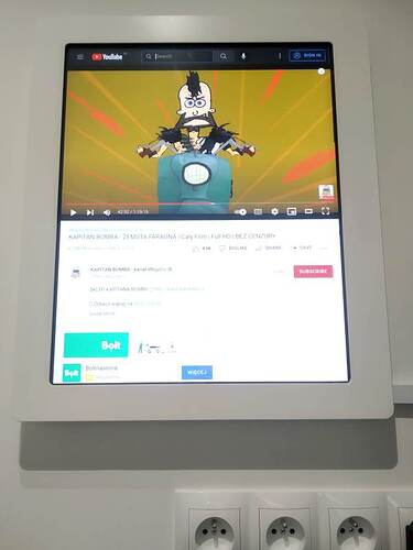

Few moments later, after connecting to PC, rotating screen and touch panel starts to cooperate:
Seems to working fine, even video was smooth:

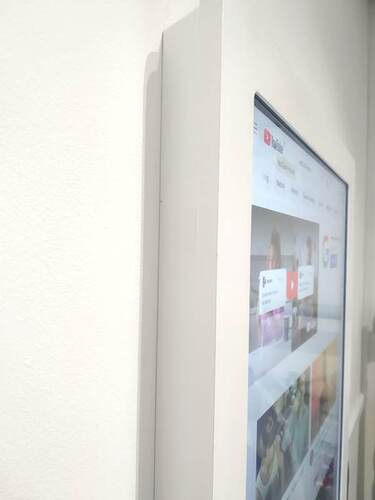

Hi, thank you for sharing your project. I’ve seen the same screen to buy and I’m thinking about it. Could you tell me something about view angles of this lcd? They are good enough (more like IPS ones) or not really (like older TFT screens)?

Please take a look at last two photos - view angles are really good. There is no problem to see sharp and colour screens almost any angle.

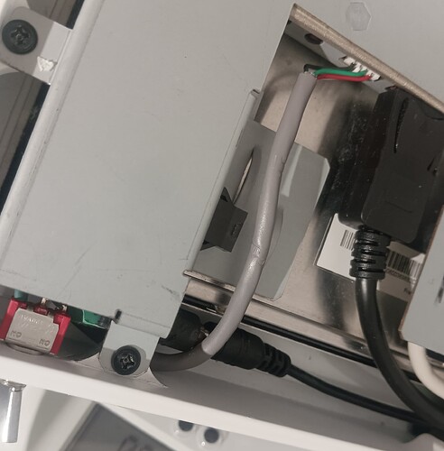

just recieved a simmilar screen, but it seems that i cannot find any power connection point.
Do I have to dismount metal backplate to find it?
Could you make photo of your screen? Bottom left corner, there should be socket with power lines, sth like that:

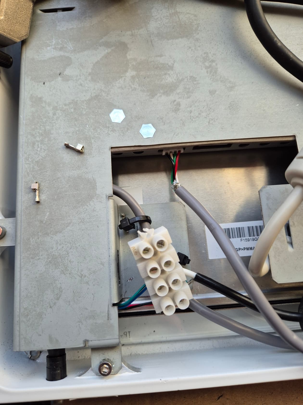

Hi. I own the same monitor. I have the same slot in the bottom left corner. I have 4 colours of wires in the 4 pin connector. Black and red are shorted to ground, while blue and green are left. How do I connect the power supply? Which wire is the ‘+’ and which is the ‘-’? Can you help me? Without knowing where the power supply is, I can’t get the monitor to work.
I don’t remember for sure - please check (using multmeter) which cable is connected to the ground, it will be “-”. Check cables inside “FCI” connector.
Hello. Hi thank you for your reply. Unfortunately I am still struggling with this topic. There are 4 wires in the socket in the lower left corner (red, black, green and blue). I checked with a multimeter, 2 of them (red and black) are ‘shorted’ to ground, that is ‘-:’. Unfortunately I still don’t know where to look for the ‘+’ power wires.
I could not find any ‘-’ wire in the FCI connector. There is only a 2-pin connector with 2 wires (white and black) that have a filter attached.

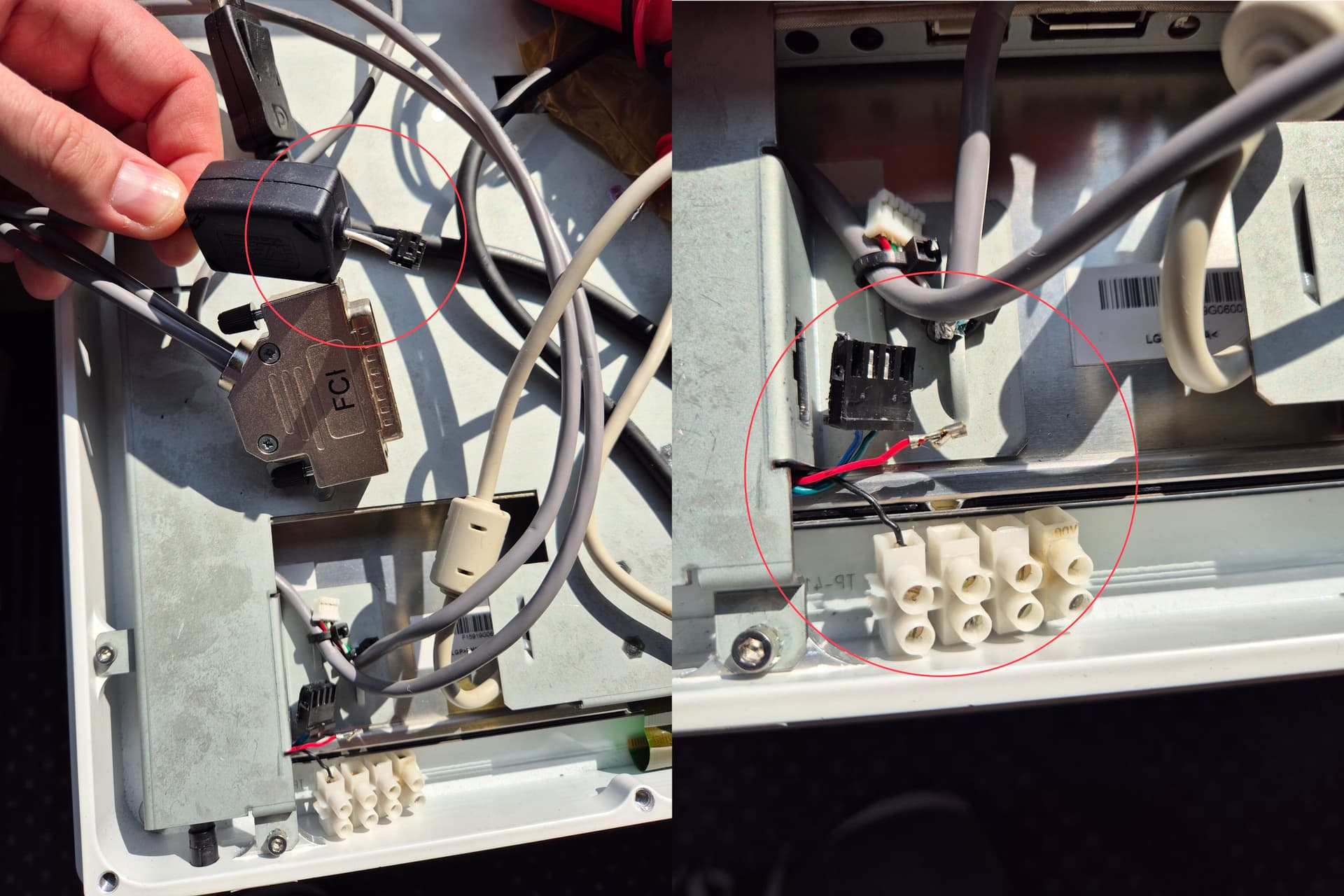

Hi!
Dissembled my monitor for sure :slight_smile:
In my version there is socket near DisplayPort socket. There are four wires (red, green, white, black). There are “+” and “-” in pairs. Check if others than red+black are shorted, they should be “+”. Check which pair is connected with chassis - it will be “-”.
As I remember, cables are paired because of current, one cable will not be enough (2-3A consumption).
Thank you for your dedication and at the same time I apologise for the inconvenience :grinning:. Your help is invaluable :slightly_smiling_face:. I have checked that plug-in you described. Unfortunately in my case the wires in this connector ‘black’ and ‘red’ are not connected to the housing.
Only the wires in the second connector at the switch show an obvious connection to the housing. ‘Black’ and ‘red’ are connected to the housing. The green and blue wires remain - these are most likely to be the ‘+’ wires.
I guess there is nothing left for me to do but connect the power supply.
