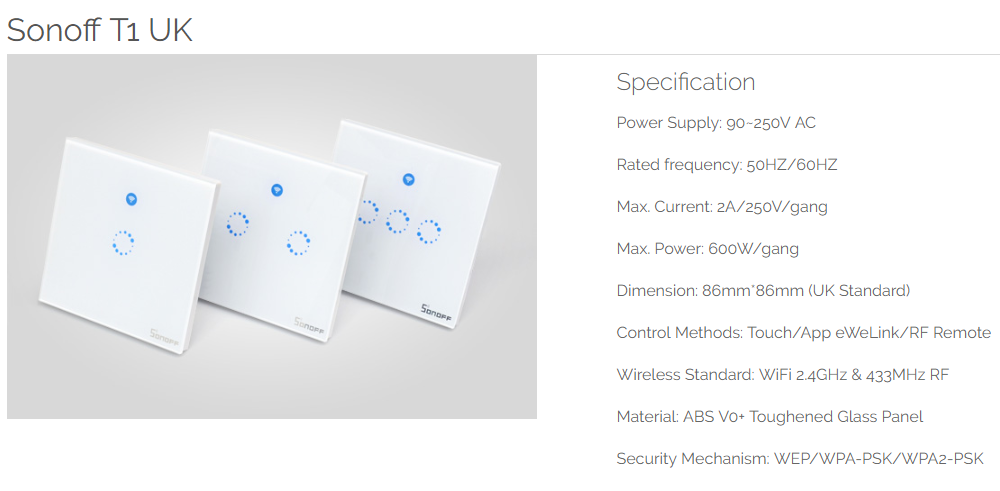

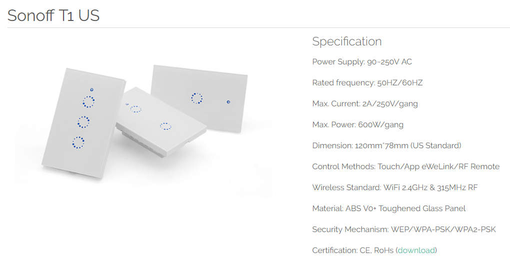

Anyway I’m going with the T1 Sonoff. anyone knows the difference between the US and EU version? I was told that the US version needed larger wall sockets?
Google? I think it’s shape AND size, both panel and the back bit that goes into the wall
Buy the US one if you live in the US, and the EU version if you live in the EU :grin:
The size and shape of wall outlets differ between the two countries, as does the voltage.
The dimensions appear to be the only thing that change.
The Voltage and frequency are the same, according to sonoff
If that’s not important in your case, buy whatever you fancy :wink:
Thank
The uk model seems smaller, and more appropriate.
The EU version only has 1 or 2 gang, and the others has 3 gang
