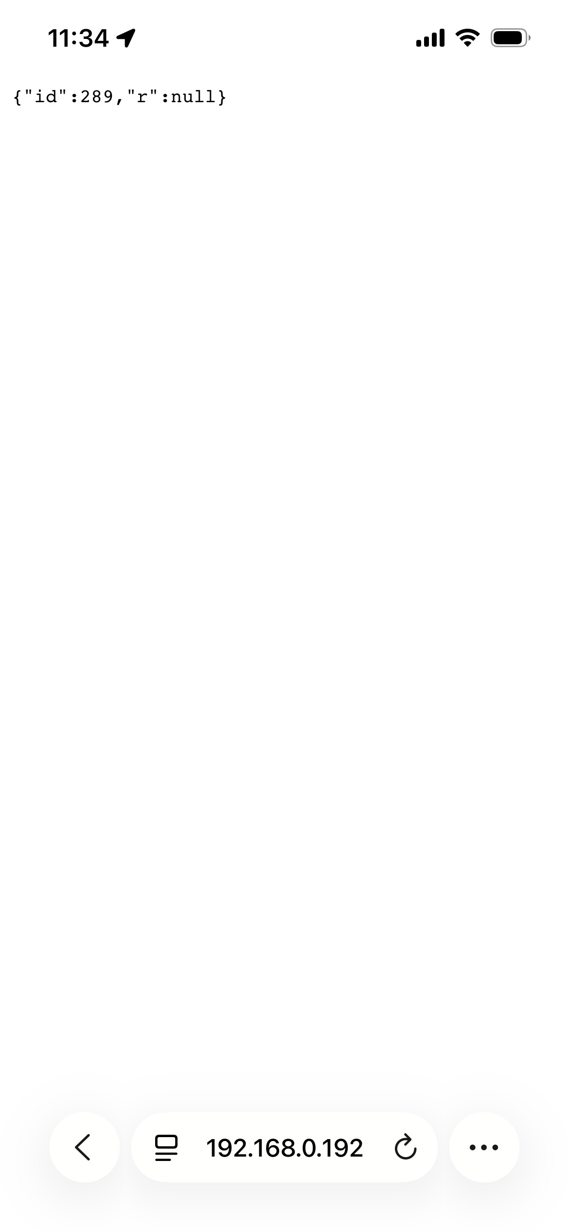

So I I reverted back to 3.2.4 beta.1 and while charging I sent http://192.168.0.192/api/command?action=stop
Here’s the result:

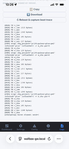

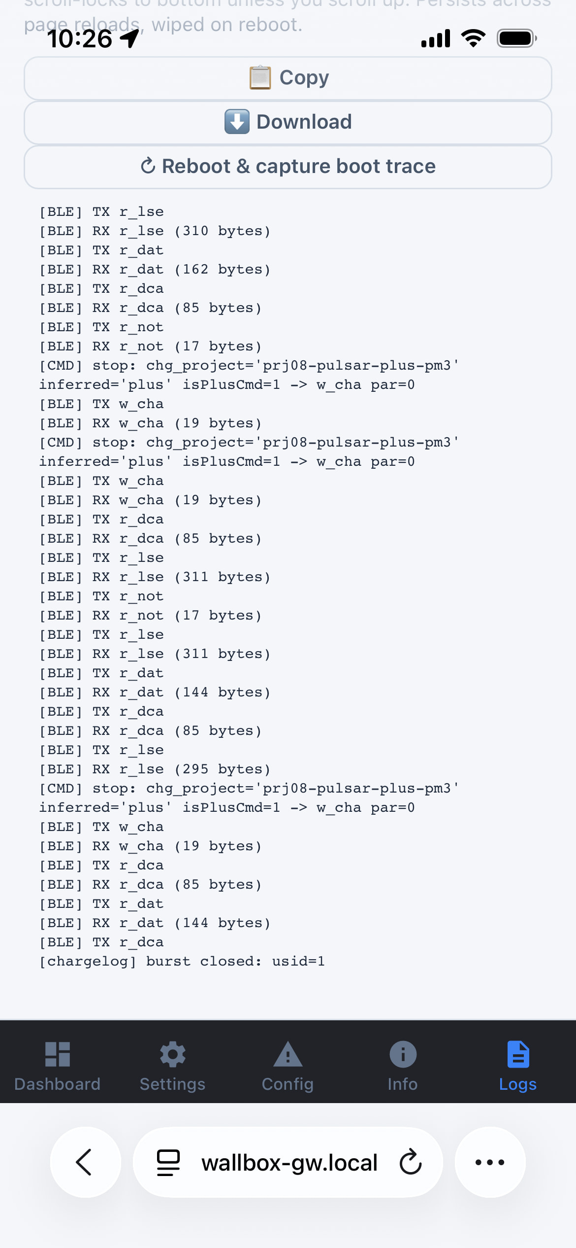

Flash it and try Stop - it should finally stop charging (now sends par=0 like the raw command). If you want to confirm, http://192.168.0.192/logs should now show a [CMD] stop: … par=0 line right when you press it. Thanks for the testing.
It worked! You’re a legend!
Webui now works perfectly. Here’s the log for the stop command:

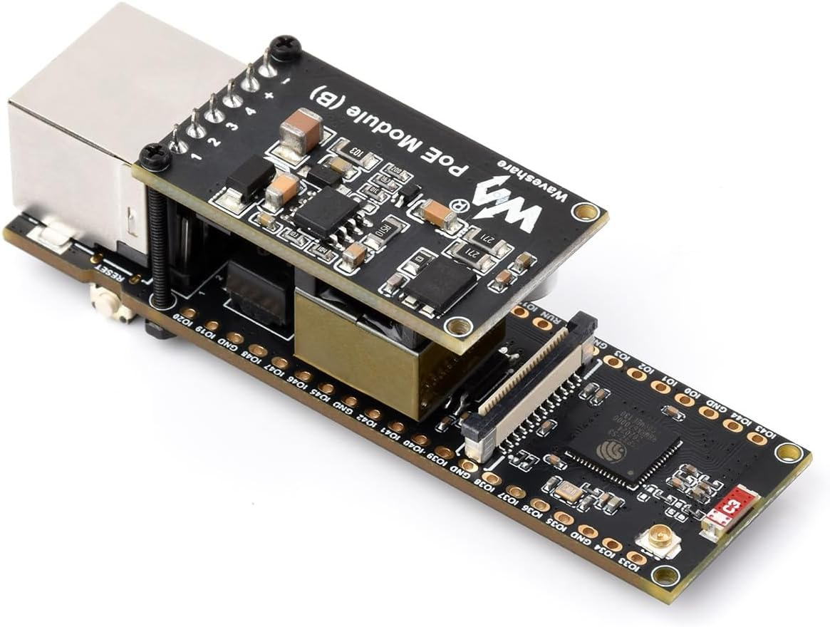

I noticed this tonight. Anyone know if there are any compatibility issues with the Gateway?
Hi @botts! I’m considering picking up one of these because I am having bad luck with WiFi for the gateway. I’m assuming this should be ok, correct? No issue using Ethernet/POE?
Perfect, that’s the base ESP32-S3-ETH - I’ve got a test build ready for it.
Heads up: it’s wired-only (no WiFi - it pulls DHCP over the RJ45). That’s the whole point: BLE gets the ESP32’s 2.4 GHz radio to itself, which should fix the flakiness you were seeing.
Brand-new, untested code - you’d be the first one on it, so treat it as experimental.

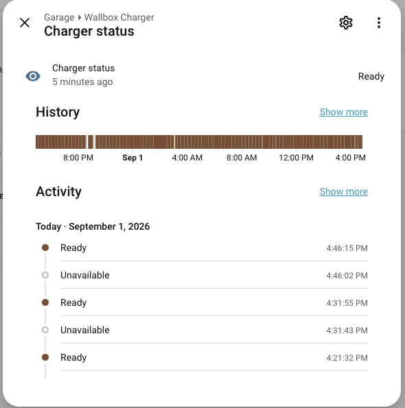

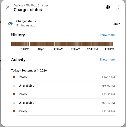

@botts I might be a step closer to ordering the POE ESP32. But I’m hoping to get your input first. It might be difficult to see in the screen shot, but all of the missing chunks in the history timeline are when the Gateway momentarily became unavailable. It happens all day long. Is that normal, or is that my wifi being dumb?
Not normal, no. Those all day gaps are almost always signal or placement rather than the gateway itself. The firmware already runs WiFi with power-save disabled and an auto-reconnect watchdog, so it isn’t the usual “ESP fell asleep” issue. Before you spend on the POE board, let’s see if the WiFi you have is fixable, because you may not need it.

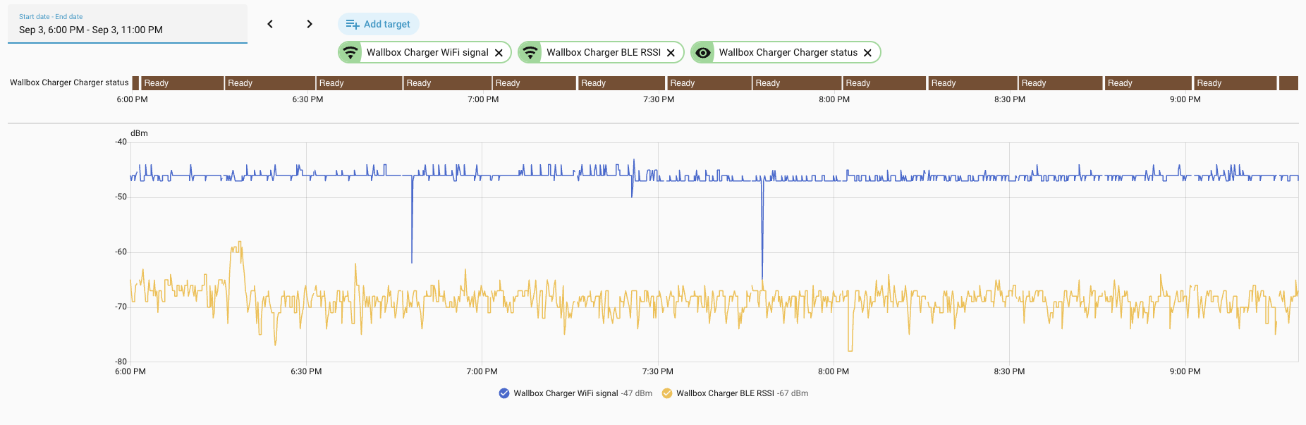

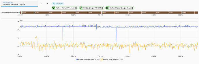

So this is interesting - I lined up the WiFi signal, BLE signal, and Status to see if the outages in Status correspond to either of the other two. They don’t. But this exercise made me noticed that the outage regularly occurs every 15 minutes like clockwork. I double checked, and I do not have any automations that would cause this. Thoughts?
And to answer your other questions -
The ESP is in the garage, not far from the charger. It lives in a plastic enclosure, along with a UniFi POE switch, backup battery, and another ESP device. The garage does get hot, but I have added some pretty good fan ventilation.
v3.2.13-rc.2
That “every 15 minutes like clockwork” detail is the useful one. First, an important reframe: the gateway’s HA availability is tied to its BLE link to the charger, not to WiFi. So when your entities go unavailable, that’s the BLE connection to the charger dropping and taking more than 60s to recover, not a WiFi problem. Worth knowing before the POE board, because Ethernet wouldn’t fix a BLE drop on its own.
Two quick checks to confirm that:
  1. During an outage, can you still load the gateway’s own web page (http://)? If yes, WiFi is fine and it’s the BLE link. If the page is also dead, then it’s WiFi/network after all.
  2. Grab a serial log at 115200 across one of the 15-minute drops. The line [BLE] Disconnected — last GATT err=X tells us whether the charger dropped us, a supervision timeout fired, or it was local. Paste it and I’ll decode the code.
On the 15-minute cadence: it isn’t any timer in the gateway (the BLE keepalive is 30s and clock sync is hourly, neither is 15 min), so it’s coming from the charger or the RF environment. Given your setup, the prime suspect is the other ESP device sharing that plastic enclosure. Two 2.4 GHz radios inches apart, and if that other device does anything periodic (a scan, a transmit burst) it can desense the gateway’s radio, which the AtomS3U’s small onboard antenna makes worse. Easiest test: power that other ESP off for an hour and see if the 15-minute pattern stops.
If it turns out to be RF contention, then wired Ethernet actually would help, since it frees the gateway’s single 2.4 GHz radio to focus entirely on BLE. But let’s confirm with the web-UI check and the serial log first, so you don’t buy hardware for the wrong problem.
