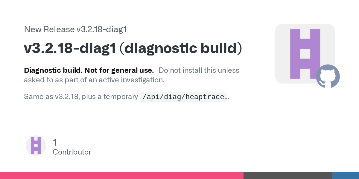

I have a short diagnostic build that will show me exactly what happens inside the gateway at the 15-minute mark. It is here, marked as a pre-release:
Install it the same way you normally update the gateway (web installer, or upload the firmware.bin under Settings). It is the same as v3.2.18 with one extra read-only page that records memory and Bluetooth activity every second.
Then, from the same machine you ran the curl test on, run this so it captures automatically across the stalls (no need to watch the clock):
while true; do date -u +%FT%TZ >> heaptrace.log; curl -s -m 8 -u admin:YOURPASS http://GATEWAY-IP/api/diag/heaptrace >> heaptrace.log; echo >> heaptrace.log; sleep 30; done
Leave it running past two or three of the 15-minute stalls, then send me heaptrace.log. It will show whether the gateway’s memory craters at that instant and what Bluetooth is doing when it does, which tells me the actual cause.
When you are done, update the gateway back to the latest normal release. This build is diagnostic only.

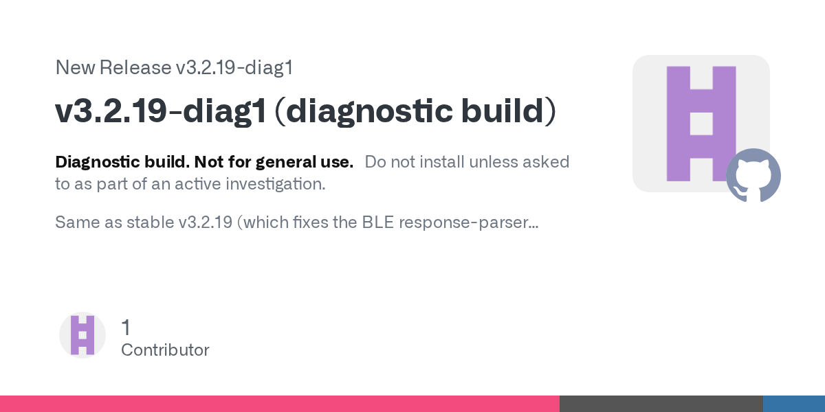

I found it, and I am confident this is the real cause. Your Pulsar Plus talks over a different Bluetooth module (BGX13P) than the chargers that were fine, and its responses arrive as a live stream. A bug in how the gateway reassembled that stream meant a single dropped or stray byte could make it buffer forever, slowly using up memory until the gateway briefly could not accept a new connection, which is your 6-second stall every 15 minutes. Fixed in v3.2.19. It affects all chargers but the Plus was by far the most exposed.
To confirm it on your gateway, here is a build with the fix plus the same memory trace as before:
Install it, run the same capture loop across two or three of the 15-minute marks, and send me the log. If it worked, memory stays healthy through those marks and the stalls are gone. Then switch to the normal v3.2.19 release.

To find and fix the real cause, I still would love one capture from the diagnostic build (v3.2.19-diag1). My leading theory now is that your Plus briefly loses its Bluetooth link when the charger does its own periodic sync, and the gateway favours Bluetooth to recover it, which starves WiFi for a few seconds. The diagnostic will confirm or rule that out. If you would rather just run v0.36.2 and be done, that is completely fine too, it should make the problem invisible.
